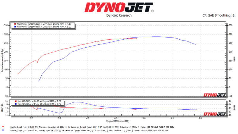

Hi I'm Michael I'm new here and I'm currently working on a 73 Dodge Charger done some modifications took it to the dyno just want to see if these are good numbers what do you think it'll run on the quarter mile or 1/8 of a mile
400 big block 30 over
7194 Edelbrock cam Camshaft Specifications: - Duration @ .050 Intake: 238 degrees - Duration @ .050 Exhaust: 246 degrees - Lift @ Valve Intake: .480" - Lift @ Valve Exhaust: .495" - Lobe Separation: 110 Degrees - Intake Centerline: 105 Degrees
750 Edelbrock Performer Series Carburetor 1411
Edelbrock RPM intake manifold 7186
TTI headers 1-3/4
Two and a half inch exhaust with MagnaFlow mufflers
High top pistons don't know the actual compression last time I checked the crank pressure they were at 145 to 155
323 rear end gears
Accel ignition coil
NGK XR5 spark plugs
Stock cylinder head [346 not ported]
Timeing at 35
Firecore spark plugs wires
Mopar distributor stock version
Torque converter TCI stall 2400 - 2600
180 thermostat
Power steering AC installed but not working
Stock crank stock fan clutch stock 727 with a shifter Improvement kit
It made 286 hp and 330 tq
Rear tire 275 60 r15

Welcome from Alabama. 145-155 cylinder pressure doesn't equal 11:1 compression to me.

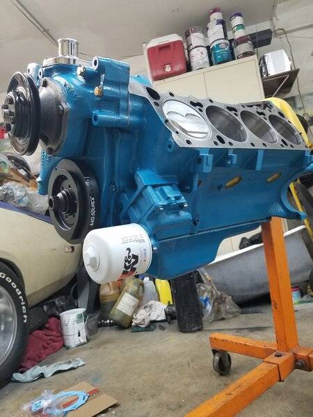

Mt question is, what pistons did you find to get that kind of compression in a 400??
What's the deck height?

As for performance, if you weigh 200 lbs, I'm betting your charger will be around 4100 at the starting line. Also, if you have 280hp at the wheels, I assume 330 at the crankshaft (somewhere around 20% drive train loss). Wallace says a mid 8, 1/8mile, and a mid 13 quarter. I think that is wildly optimistic. With good tires, (t/a's arent!!) I would be very happy with a high 13/low 14 with your combo, as it is with 3.23.
My 72 Charger weighed 4200# with me in it. 3.91 gear sure grip, automatic, 275/60-15 tire. Dynoed at the tire 255HP, 350 TQ. Ran low 15's quarter mile. Best run ever in Vegas was a 14.9. You are very similar in weight and power.

Do you know what your initial timing is? You want as much initial as it will take without pinging to add some snappiness to it. If your T/A's are a bit old rubbing them with gas sometimes will soften them up. The 3.23, tall tire and relatively low stall speed all combine to slow up your ET.

I don't know the initial.. I just put a to 35 on the dyno.. my t/a tires are pretty new.. maybe like 5 months or 4 months.. you think a better torque converter would help faster ET??
