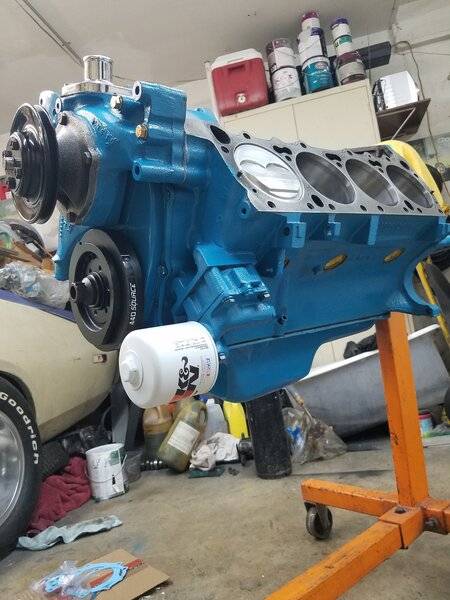

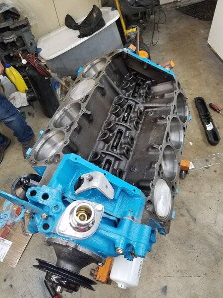

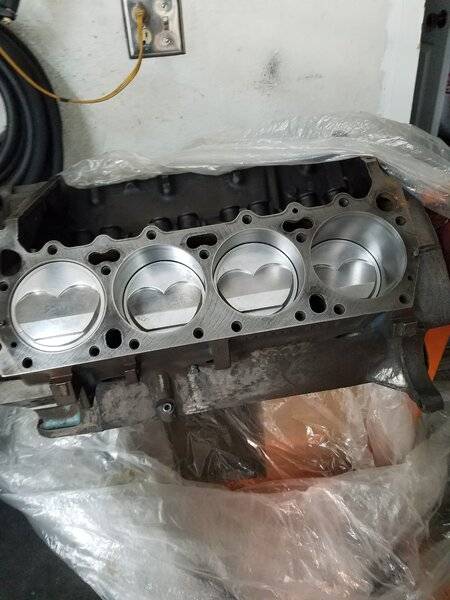

I haven't read the whole thread. What Pistons are in yours? (The factory pistons were so far down the hole stock, that there was little compression, but no quench at all, and even though the compression ratio was very low, it had poor knock resistance. To keep them from knocking the timing got pulled back. Perfect recipe for a dog. Major reason why stroking 400s is so popular. Lots of piston choices for a stroker.)That is nothing... you think I'll be able to run 89 octane or should I just stick with 91?... you think I could get more compression with the thinner gasket but I want to try to run only 91 max I don't want to run additive that would get very annoying every time I fill up I would have to add additive
A stock stroke 400 CAN be a runner, depending on what pistons are used. Though IQ52 has recipes for making a low compression one RUN!
