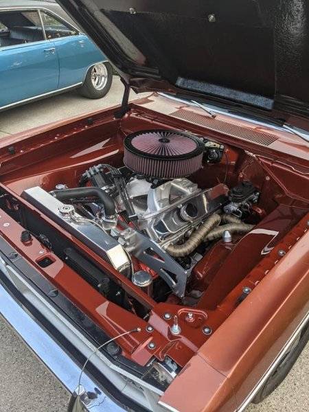

I'm with you!I have a buddy who’s been a small block “A” body guy for years. After driving my roadrunner his dart now sports a 499… lol
