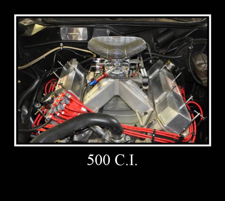

You can build a 451,470,500 or 512 using the 400, or a 500,512,528 or 543 using a 440 block, 440 source has all those kits and they're all the same price $1,997.00 and include: the crank, rods, pistons, rings, bearings and a balance job..I have a 440/512 in my Coronet and it makes 550 H.P. and over 600 ft.lbs of torque.

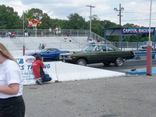

You can also make a 400 run without stroking it. This is my sons Dart with a stock stroke .030 over 400 (406). It has KB pistons and stock Eddy RPM heads that were cut so it has 10.6 comp. He runs the MP .557 cam and the car has 3.91's in it. He has run a best of 11.49 @ 117. Everyone thinks it's stroked but it is not. Course a nice stroker should put it in the 10's with ease. Ron
Wouldn't be hard to put that Dart into the 10s with that same engine.....
