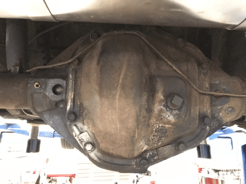

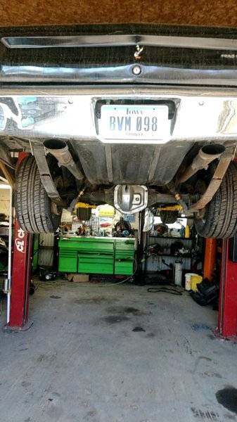

3. The car has a Dyna rear end. Don't know what the gear ratio is. If I mark the rear tire and the drive shaft, what's the calculations as to the number of turns each that would give me that ratio?

3. Dana's are cool. Stock rear end ratios are 3.54 or 4.10. If it drives pretty "normal" on the highway, you've got 3.54. If the engine is SCREAMING on the highway (high rpm) you have 4.10
Chalk mark tire and driveshaft. Turn tire one turn while counting how many turns of driveshaft. Purplebeeper's scrwaming on the highway is oh so true. Put 4.10's in my car 3500 rpms and I was being passed by everyone. There 3.73 and 3.91's but not common ratios.
69 roadrunners only had danas behind hemis and 440 sixpacks, no standard 440s either. I'm guessing that your drivetrain is not stock, so the dana could be an open, from a truck. First put both rear tires up in the air, and turn one tire. If the opposite tire turns in the same direction, you have a sure grip (most likely). Then turn the tires onr revolution and watch the driveshaft. Three and a half turns, 3.54, just over four turns, 4.10, just over four and a half, 4.56. If you get something under three and a half turns,(assuming it's not an open) then you might have a dana 61.
If you have an open, there are several good videos on you tube to determine what ratio you have.
Odds are it is a 3.54 sure grip, unless its a narrowed truck rearend.
Thanks for the reply 33 IMP. This car seems to have been through many hands before me; not sure what I got. 69 Roadrunner coupe; pretty sure the 440 six pack cam out of a 70 something. No sure about the 727 trans or the Dana rear end. I'm learning and taking notes. I'll check for those videos.

Dana has a distinctive case.
