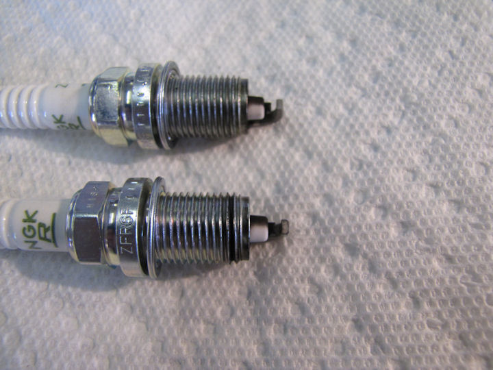

Update: still wrestling with the rich idle. Took out a couple spark plugs with about 20min run time - interesting pattern, black on one side, white on the other. Checked a couple others, same appearance. Can anyone tell me what this means?
Those plugs do look odd. And also strange the color is on the same side of the plug since I doubt they index exactly the same in two different cylinders. Just to throw out a theory here, maybe it's possible the dark side could be where the spark is initiated and starting the burn cycle because the plug is sharper at that point. And maybe after the plug fires more cycles it finds a new area to spark and keeps finding new sharper areas throughout it's life. I don't recall seeing any new plug with very little run time have complete coloring.
Fellow on another forum said this pattern could indicate oil being drawn from the valve seals or intake gasket. Not good. He suggested I put some new plugs in, mark the porcelain such that when removed the orientation of the darkened area can be determined, that is, does it map to the intake valve.
