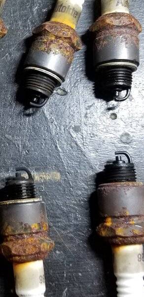

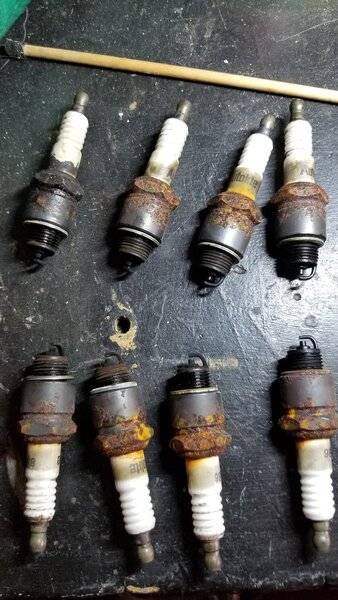

      It didn't seam like it was dripping, it was a steady squirt every press of the gas pedal, before it started up again anyway. Also, these are the plugs just removed. Oriented with left being front of engine. Thoughts other than insane corrosion?

      Looks rich but need a closer picture of gap.

      Yeah, looks rich. But that wouldn’t cause what you describe.

      Per request, thanks.

      Looks more like center carb issues possibly cracked base.

      So, that squirt is from the accelerator pump squirter (shooter), not "jets". Plugs look like rich carb or weak ignition. Take a hard look at the bulkhead connector, where wires go through the firewall. Look for corrosion & clean.

          The plugs look rich from it being cranked and not firing.

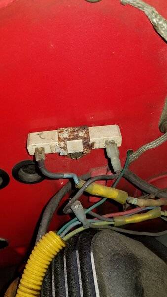

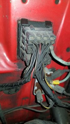

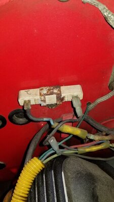

            Busy day today but I snapped pictures of the bulkhead connector and ballast resistor for scrutiny-sake. I'll try to see if there is any arcing when it gets dark tonight.

            The normal issue with the bulkhead connector is not arching, it's corrosion in the male/female plugs. You need to pull it apart & clean the contacts. In my experience a ballast resistor is good or bad, not intermittent. A simple check with a VOM meter tells you if the resistor is bad. Check the plug on the ECU & the ECU pins for corrosion. The ECU needs a GOOD ground. I sanded the ECU case at the mount hole & ran a separate ground wire to a a really good ground source. Still make sure your float levels aren't going goofy.
