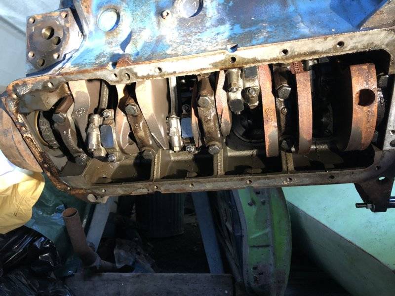

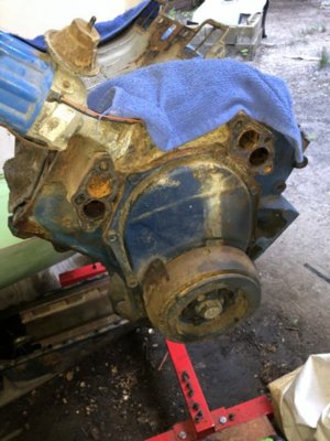

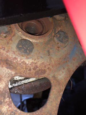

So the block is a 76’ and the heads are 452s which were for 400-440 from 76-78. The shaft looks like it is drilled out or cast with a hole in the end. I tried to take a pic but it’s on the stand.
It was a gamble on this 440 because it had been sitting for many years. I was really happy when I opened it up and didn’t see much gunk!
I will try to post some pics.

I posted some pics. What do you think?

I posted some pics.
Hi,
The end of the crank is not drilled for the regular pilot bearing on an A833. It's looks like your doing the "full monty" on this 440. The damper and the crank are externally balanced pieces. You have to decide how much HP/Trq you want to build and stay within the performance envelope of the bottom end. Trust me, it will be plenty fast!!!
So do your search on the adapter parts and see what the cost of having your shop drill the crank is. Just look at the chevy weenies with cast cranks, the upper limit is more than enough power.

Agreed. And honestly, these days, it’s cost about the same to just buy a new, balanced rotating assembly as it does to pay for machine work. Which is what I should have done. By the end of it, I was in only 150 bucks less than a 440 source 505 stroker kit

1. That is a cast crank motor (externally balanced)
2. The crank is not drilled for an A-833. You can cut about 1" off the nose of the transmission input shaft and use the Dakota roller bearing (works just fine)
3. No problem at all using the "motor home heads" in a car (they're actually better in my opinion & you're lucky if you have them). They may have an extra "cooling loop" around the spark plugs & extra cooling passage holes in the block (these can be drilled into a non motor home block). You'd need special head gaskets with extra holes to use these heads.
4. I "think" you can get a flywheel weighted correctly to balance a cast crank motor ??? (cast crank motors were never available with a 4 seed that I'm aware of)

advice is good on the Dakota roller bearing- it works better than a bushing

FWIW, As far a depth, I believe an un-cut input would need approximately 2.120" + some clearance into the crank. A steel "auto" crank I have is factory drilled to 2.225", it's deep enough, but the bushing bore area is not at finish diameter. No idea what's possible for depth/diameters on a cast. Don't open up any oil passages! ..…….
