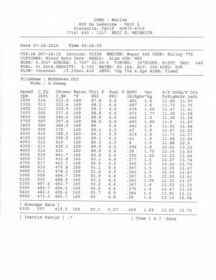

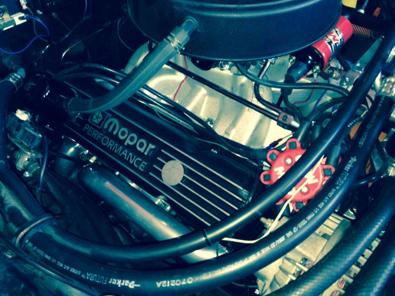

Close to my budget build for the street
Stock 440, .030 over
SRP pistons, 10:1 CR
Edelbrock 60929 heads
Edelbrock Performer RPM intake
Holley Street Avenger 770

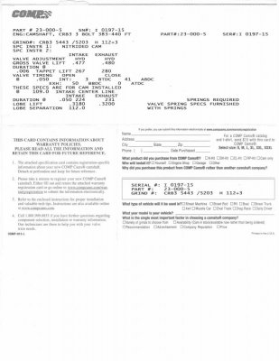

Comp cam, hydraulic lifters, rockers
MSD 8387 distributor
