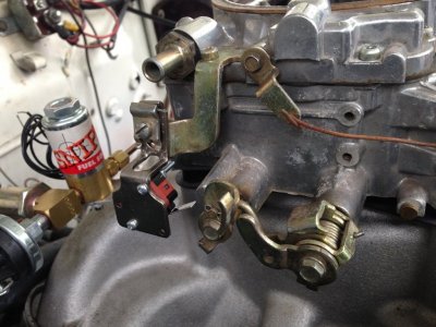

Carter fuel pump and aluminium fuel line installed for the nitrous
Solenoids and fuel regulator installed.

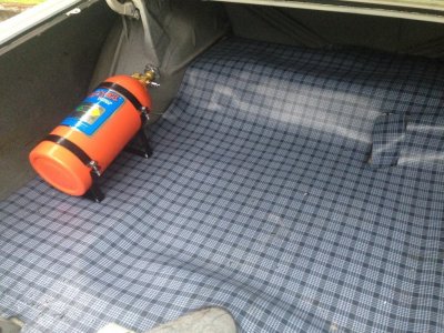

Bottle and wot switch got installed last evening.

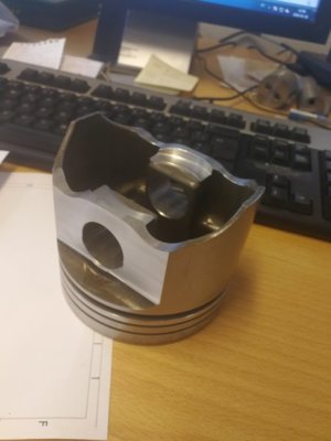

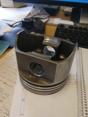

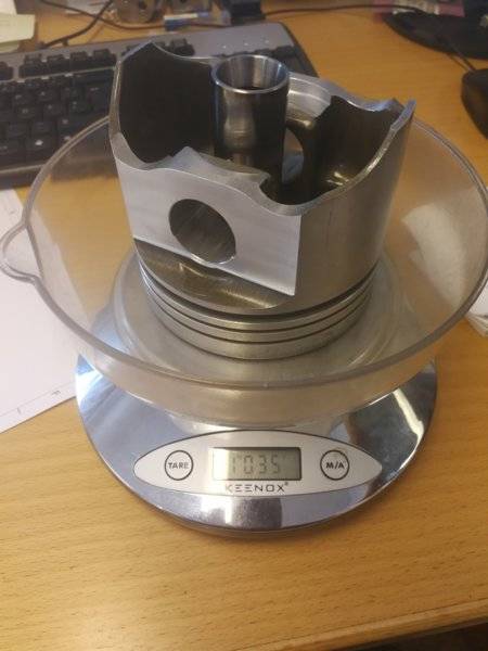

Finally found a set of speed pro l2355 pistons in std bore dimension.
I have lighten the pistons and wrist pins, so they will match the stock low comp pistons weight.
