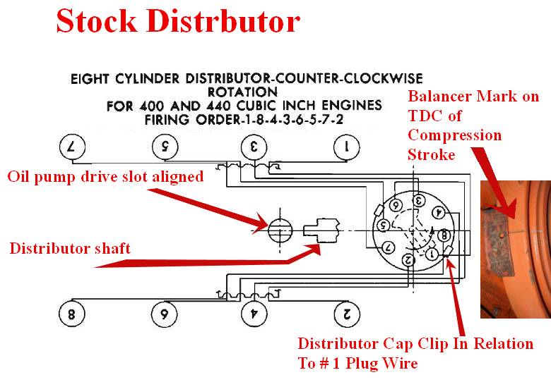

?? You have verified the firing order.....
Could be something in the distrib also they are 180 out in the firing order.

Seems odd, because 5 and 8 are directly across from each other on the distributor. Maybe try swapping those 2 positions where the wires plug in to the dist, but leave the wires hooked to the same plug they are on.
