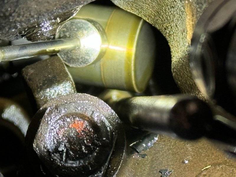

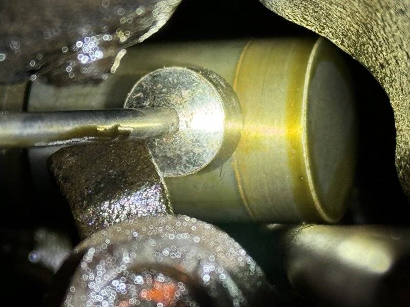

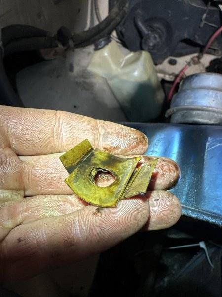

Those flakes just beneath the bolt head in your picture; are they loose? If those and others like them are loose inside your engine that would be cause for concern.

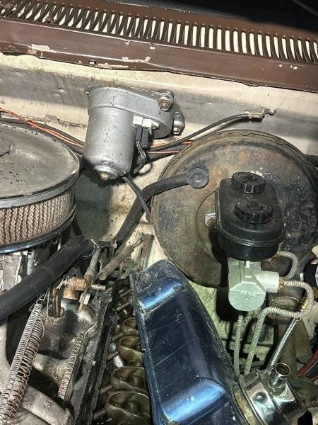

Just tried, no luck….brake booster coming out..Put it back on at the front, slide it forward then tip the other way or roll up. The only rocker I had to unbolt a motor for was a 70's straight six Rambler.
Someone was trying to correct the valve train geometry.Removed brake booster and got the cover off. Found these shims between the rocker shaft and the head. Why would that be there? doesn’t look right

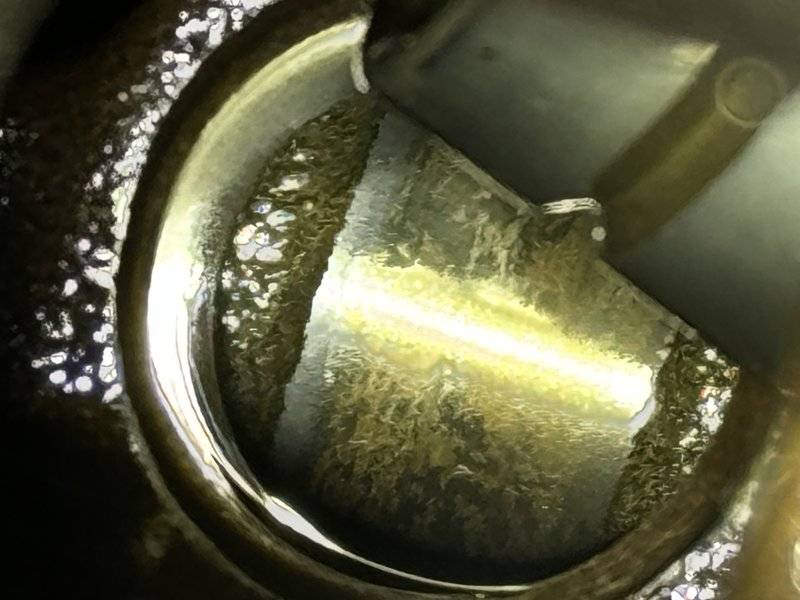

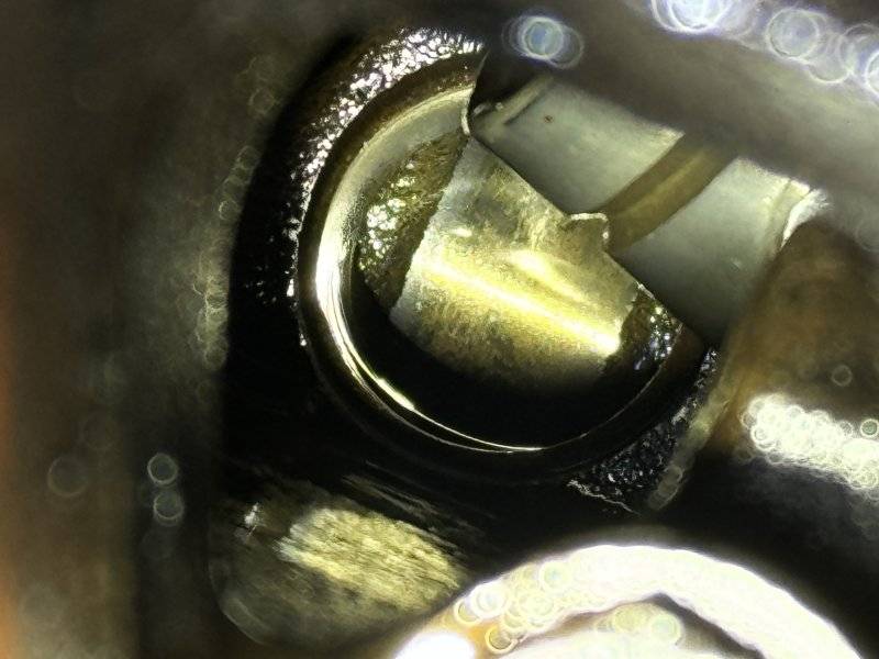

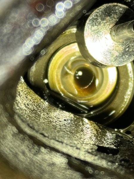

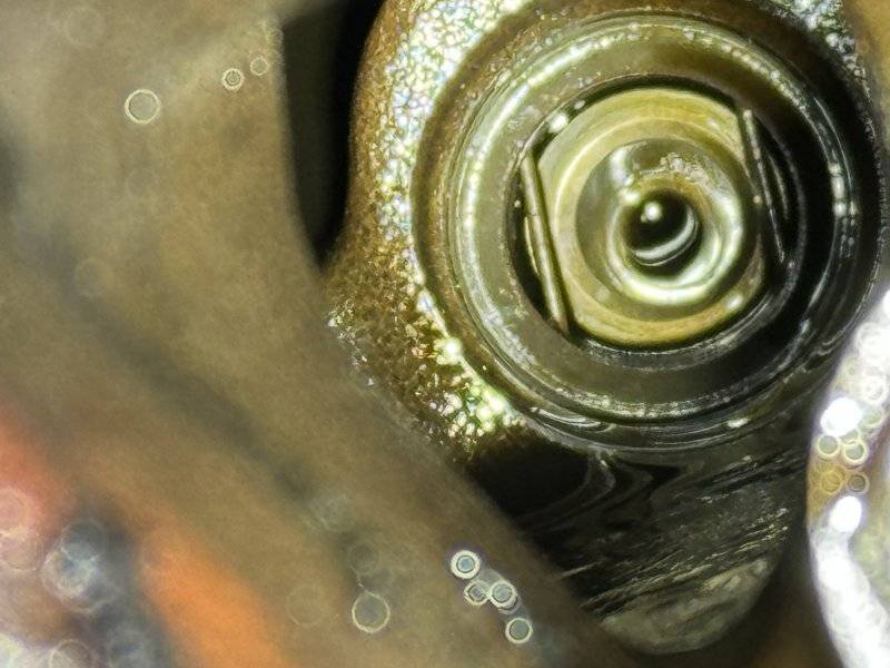

Even if the cam is wore down to the base circle the pushrod shouldn't just pop out.pushrods don't just fall into the valley... i would at least make sure the cam lobe is still there, can do that with the intake on..
You can. Then with the covers off just crank it for a while and watch every rocker. If it all looks ok put the covers on and run it.Should I just throw it all back together with the shims and see how she acts? What about the low cyl pressure in #3 anything I can do to diagnose while covers are off? I am done working on it for the night! Will continue tomorrow, thanks everyone
I tried moving the linkage before moving booster…. No go…I think I would have moved the throttle linkage and kick down before I moved the booster, and flipped the cover the other way......

Will do when I get home this afternoon….might I add that this truck had sat for about 4-5 years without running.It's all alluding to a possible stuck valve, pushrod fell out, lifter popped up. Side benefit; the other bad cylinder has stuck valve issues. Pull both rocker shish kabobs and check valve heights with a straight edge
