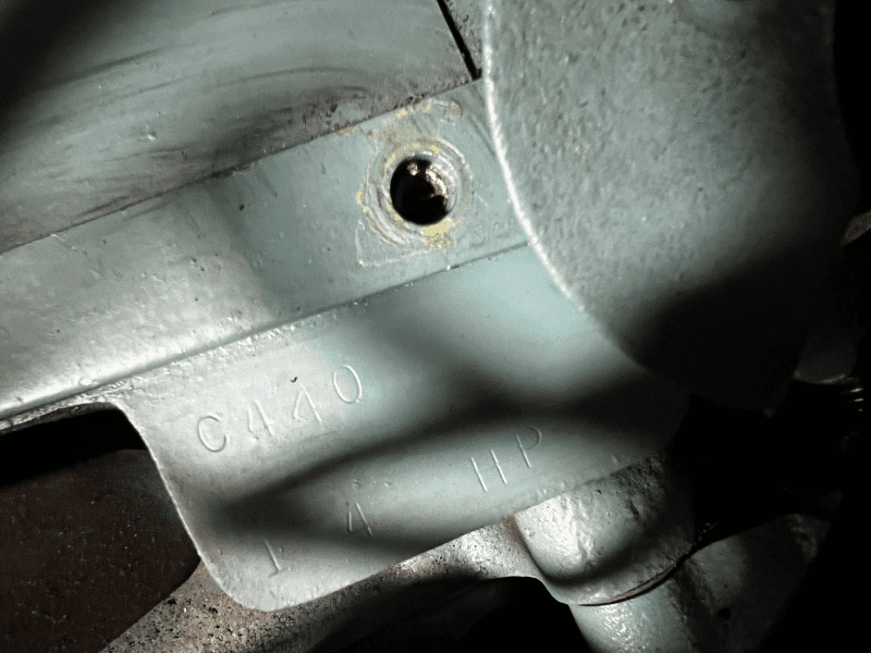

Finally got the time to get to the car and here is what is seen on the pad
Let's see if I decipher the numbers correctly
C=1967
440 engine
Jan 4 build date
HP= High Perfomance
