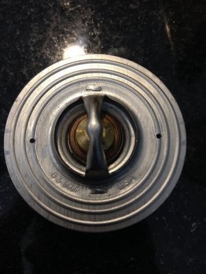

Also - what brand of thermostats are you guys using? In my gen3 hemi I was running nothing else than the Jet thermostats - but old cars are new territory to me lol
