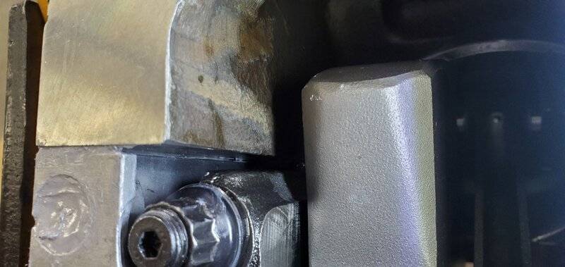

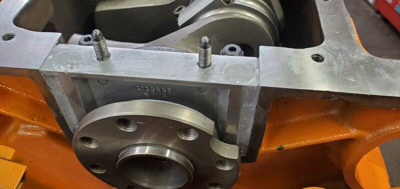

Just put the rear main seal in my receptor today. Tried offsetting the seal. Found it easier to start the seal in the block against the crank. Then lower the retainer down on to it. Filled the side grooves with rrv 1st. A little anaerobic on the retainer and bolt it down. Then fill the outside 45 degree recesses and the bolt holes. As you can see in the last pic the rtv makes its way inside the edge of the retainer. No leaks here.
Doug

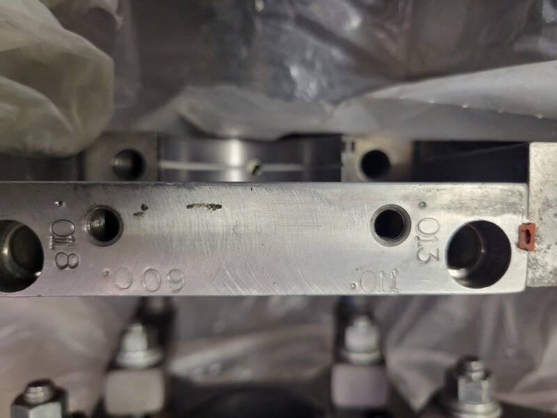

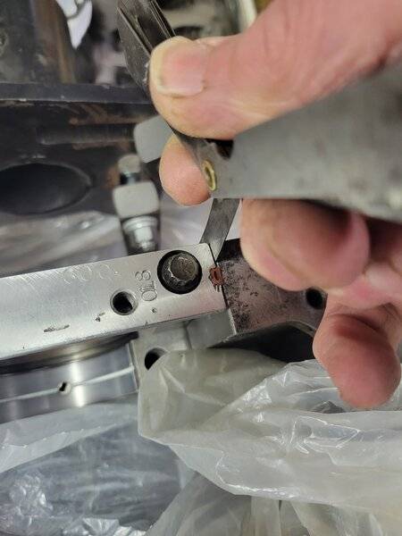

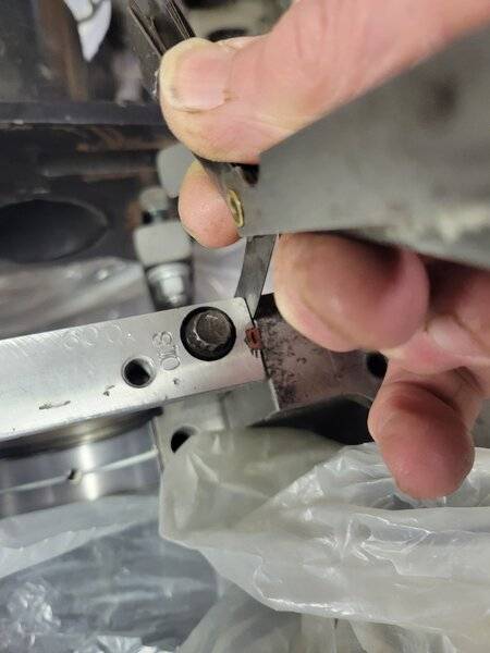

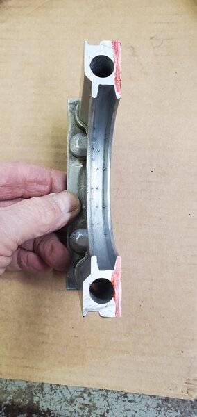

You need to make sure the seal ends are lined up and that the seal actually touches the crank, factory machining it pretty bad as the rope seal made it not important. This block needs the seal retainer moved to the right about .005. I stamp the feeler gage size on the retainer for the next guy or easy in car changes. The other 2 figures on the back of retainer are how far in the retainer is from the rear of the block. This one is close, some are way worse and by the time you move it over enough the side seal does not touch.
Feeler goes here, torque one up with no crank and look sometime, then put the crank in and see if the seal touches all the way around.
