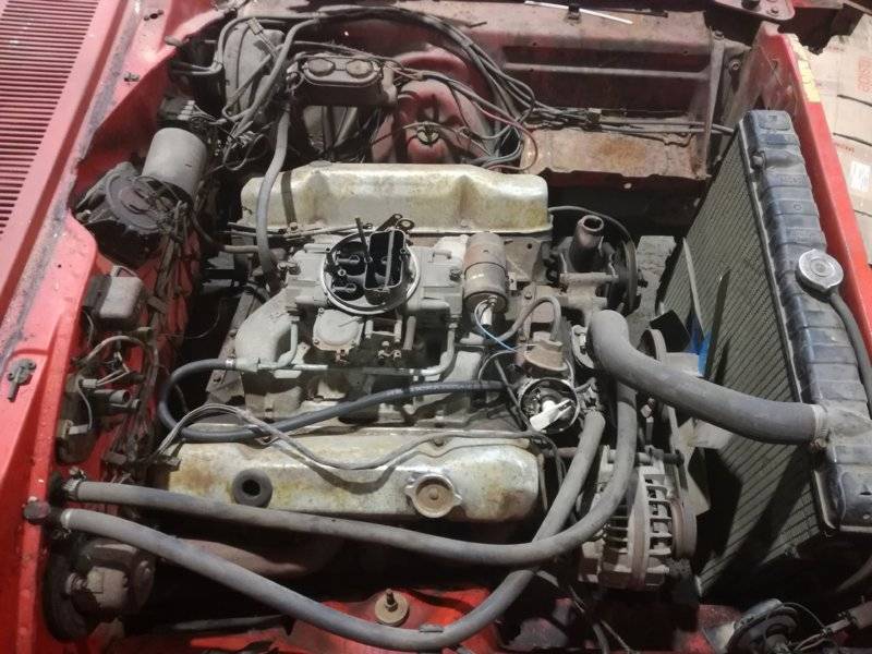

Engine was swapped in my 69' RT Charger. Before me there was instaled some aftermarket manifolds (tomorrow will post a pictures).

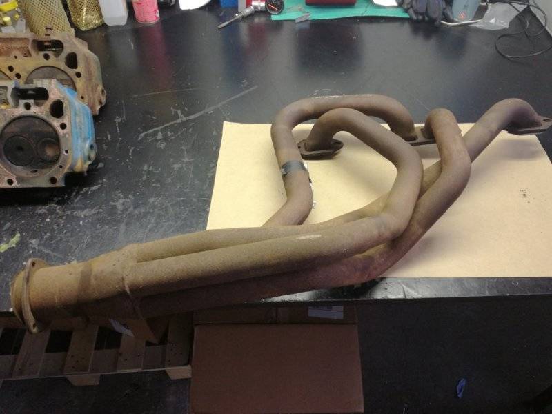

nice headers
