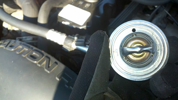

My favorite method of getting rid of air pockets is to drill a small 3/16" diameter hole in the thermostat like this.

Lower hose could be collapsing....is the thermostat opening ? Condition of waterpump and how old is the rad...26 inch 4 core ? timming? and I always drill a hole or two in the stat
