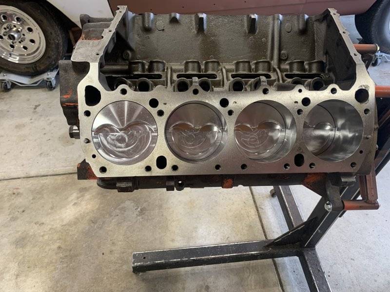

So I get my 440 short block build back from machine shop, and find this was wanting.010-.015 below deck looks like crank was ground different on #5 and 7, which I have a positive deck height. Should I be worried about this?
Stock ground crank, icon 836 pistons, molnar rods
Yes I would be. You can install a thick gasket to get the right piston to head clearance, on the tall ones, but then the other cylinders will be down on compression. The whole idea behind blueprinting an engine is that all 8 cylinders are exactly the same.

So I am checking deck height of pistons here, 5 and 6 are on the same rod Joe Al of crank, everything seems close except for the deck height of 5 and 6, seems to me like the crank on that journal wasn’t ground same as the others?
Not sure how to fix it, mill top of pistons on them 2 cylinders?

Here is a better picture everything is pretty close right side of block 2 and 8 are both .011 down, left side 1 and 7 are within a couple of thousandths, the problem is cylinders 5 and 6 are positive sticking up out of cylinders.005 and .007 thousandths. Decks look pretty level to me not perfect but plenty close. With exception of cylinder's 5&6 which seems to me the crank on that journal was ground different then the rest
That's effed up, It looks like the crankshaft was ground wrong. You can check how far in the hole they are at BDC then you'll know for sure whether it's an effed up crank or wrong height rods or pistons. It has to be fixed. Crank ground wrong will be longer stroke, wrong height pistons or rods will be the same stroke.
