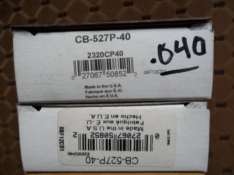

Almost impossible to get .040 bearings, I've tried.
And then there's balancing..
They make .040" under bearings in small quantities, or another crank and balance it.
Small quantities as in, custom just for you.
King bearings will, apparently.
How long and at what cost is the issue.
Never used Kings, yet. Below are Perfect Circle/Vandervell CL77s. I always try to keep stuff that can have lead time on the shelf.
I think it says '08 on the box, can't remember exactly when I got them. I believe I saw some .040s on ebay this year; I just got three sets of std LB mains this week as I had a couple 440 cranks turned down to LB mains recently. I still buy internal engine parts in lesser quantities compared to years ago.
When I was more serious about about racing, 35+ years ago, I used to get them in quantity, sometimes by the case, mostly Mopar for CL77s and Childs & Albert for their high quality Babbitts. I used to run a stick car, and I would pull the pan and check the main #3 thrusts and a couple rod bearings and toss them after about every day of racing. I still have a shelf full of RB thrust bearings, doubt I'll use too many of those at this point.

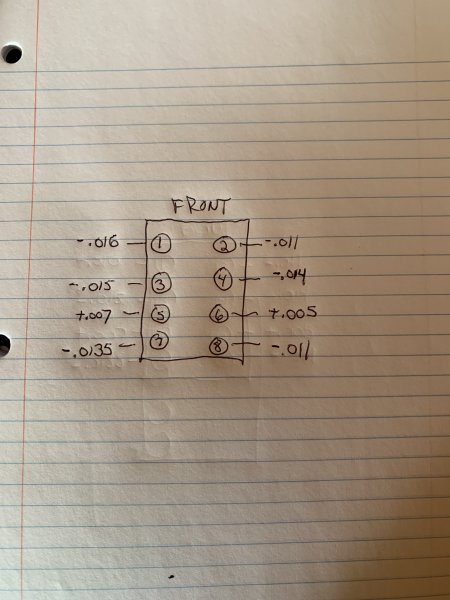

Here is a better picture everything is pretty close right side of block 2 and 8 are both .011 down, left side 1 and 7 are within a couple of thousandths, the problem is cylinders 5 and 6 are positive sticking up out of cylinders.005 and .007 thousandths. Decks look pretty level to me not perfect but plenty close. With exception of cylinder's 5&6 which seems to me the crank on that journal was ground different then the rest
Like everyone else, 99.9% sure it’s the crank. But you need to take and swap the #1, 3, or 7 rod and piston into the #5 hole to confirm.
I did check the rods with dial calipers before giving them to engine builder, they definitely wasn’t .020 difference in length. The engine is a 71 out of a cuda I have had for 25 years. It was a standard bore, crank was standard on Rods and mains. It had a spun rod bearing. I informed him to check it out before doing anything and if needed I would get a new crank.
