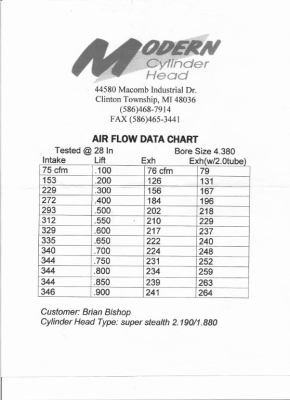

The standard Stealth head comes OOTB 275-285 cfm. Certainly not enough flow for 725 HP. You must port the Stealth to get 725 HP.
I've never seen an AS CAST head that will make 725 HP. They all have to be ported to get that level of performance. Why buy another head, IF YOU ALREADY OWN Stealth heads and all you want is 725 HP? Just have the Stealth heads ported.
If you don't have any heads and you want more than 700 HP, don't start with the Stealth head, get a better head to start with and have it ported.
ANY AFTERMARKET ALUMINUM HEAD, THAT YOU ALREADY OWN, CAN BE MADE TO GO 700+ HP, ANY OF THEM! So you don't have to buy another head if that is your maximum goal.
Never used them, but what I think I see is a chinese Victor. The flow tests I have seen, but never done personally, seem to say they don't flow as good OOTB as the Victor. Their ultimate potential is unknown to me at this time as I have never tested them. Like I said above though, I'm sure they will go 700+ HP. For crying out loud, we get 730+ HP from ported factory 906 heads.
