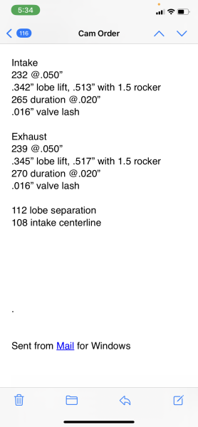

So I am building a 440 it’s going to be stock stroke .030 over with exhaust manifolds rpm intake manifold , car is a 69 roadrunner 3.73 gear auto this is the sft cam I was recommended what do you guys think and what compression ratio should a do ( stealth heads with checked and valve job redone).Car will just be street driven but looking for a little power want to run on 93 pump thanks for any advice
This is on order at bullet it’s 7 weeks out so I can change it, this was what he recommended I was thinking it might be a little more than the manifolds want. What should I change?
Looks like a pretty good manifold cam. The carb, intake, and converter play a role in cam choice.
Run 10.0 to 10.3:1 compression with quench. Cam timing matters here as well.
Overall, it kinda depends on how much power you want, and how close to the edge you’re comfortable with.
If you told the guys at Bullet all about your parts combo and intentios, I wouldn't change anything.
Honestly...if Tim (or someone else there) recommended this cam, the last thing you should be doing is second-guessing them with internet advice! You won't be disappointed. They're a good outfit and they know Mopar engines.

The guys at Bullet can only help you based off the info you give them. Sounds like the info may have been a bit vague??
To me Bullet’s cam looks pretty small for a sold flat tappet, even with HP manifolds. I would go one step above that, the exh profile would be on the intake, and either run it as a single pattern cam on 112 LSA or add a little more exhaust duration (depending on the static compression and how high your stall is). I would add 8* for 247* @.050” on the exhaust if you have a decent stall (over 4000). If it is 3000 run it as a single pattern. It will be more forgiving on fuel and make more power with a little bigger cam. That cam would be fine with a stock converter, but it is leaving a fair amount of performance being that small. The .016” lash take off about 8* of duration at .050”. It will only be about 224* and 231* at .050” after the lash is taken up. Ok for a stock stall and 9:1 to 9.5:1 compression. I wouldn’t go higher than 9.5, above 9.5 won’t gain much power with that cam.

The back story on the car is I bought it in 1989 it was a old school bracket race car.It’s a real 69.5 a12 roadrunner original drivetrain was not in it. It had 4.88 8 3/4 with a ladder bar and 6 point cage. The engine in it is a 383 with 2293 trw pistons and cam dynamics sft.mild ported 906 I ran 2” primary super comp headers. From what I remember in 3rd gear rolling along the j converter would flash to about 3800-4000. I have been putting it back to more stockish condition roll bar is cut out, it has new leaf springs and a Dana 60 with 3.73 gear so this engine combo is going to be all new I told bullet what I had and goals for the cam. Wanting something fairly mild to eventually( when I can afford it) put a 6 pack back on. Going to run a rpm intake for now. I wanted a sft because I have adjustable rockers already and I can keep i eye on lifter wear by checking lash occasionally. I respect and appreciate all advice so I can end up with a car that runs good would be happy if it was capable of some high 12’s and look stock
From your description my thoughts are still go with the next size bigger cam. The cam they recommended won’t lope at all. Maybe you want a completely smooth idle and that is why they recommended it??? Nothing against Bullet, we run mostly Bullet cams.

If it were mine I would ask them to jump up a size 239* on the intake and 247* on the exh on 112. It would lope some, still very mild though.
The combination you have described will get you to the high 12s @ about 110 mph with a stock converter and BFG street tires and a crappy 2.0 sec. 60 ft at an Ohio track in good air.
