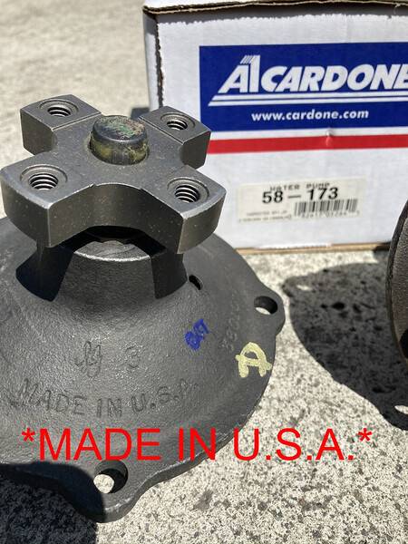

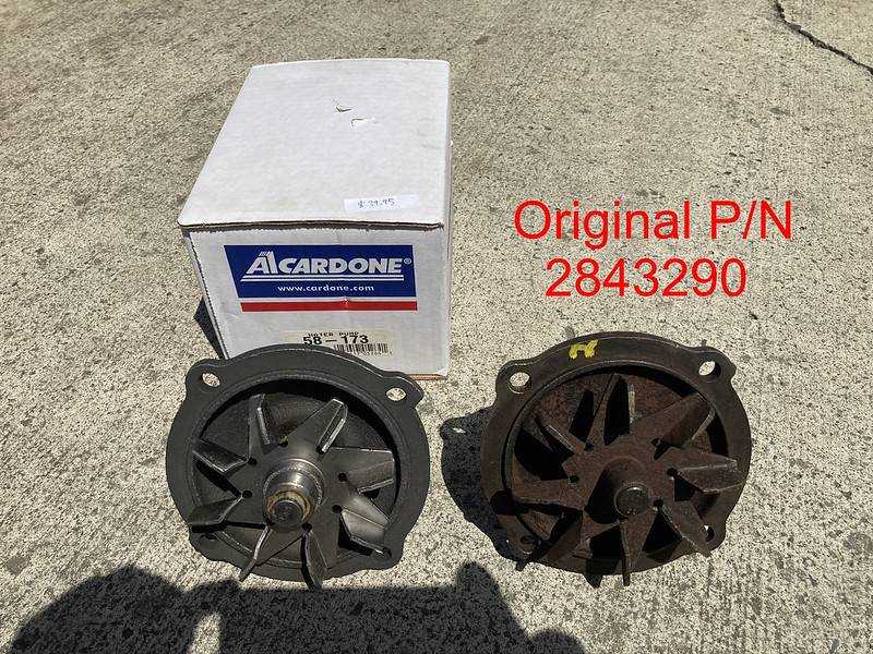

Thanks for this article! My complaints are very similar. I’m putting the stock iron housing back on tonight along with the stock pump. Hope this works! SonnyAfter reading thorough this whole thread: http://www.dodgecharger.com/forum/index.php/topic,60599.0.html
I'm using the stock cast iron water pump housing and this A1-Cardone water pump P/N #58-173. Can be had for $37.79 at RockAuto
Notice how the impeller is pretty close to factory and...
MADE IN USA... USA... USA... USA.. USA...

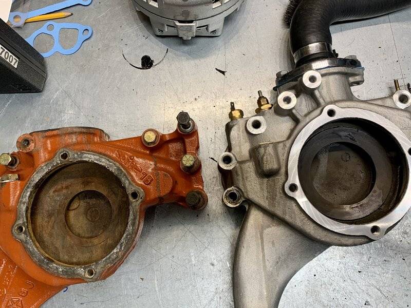

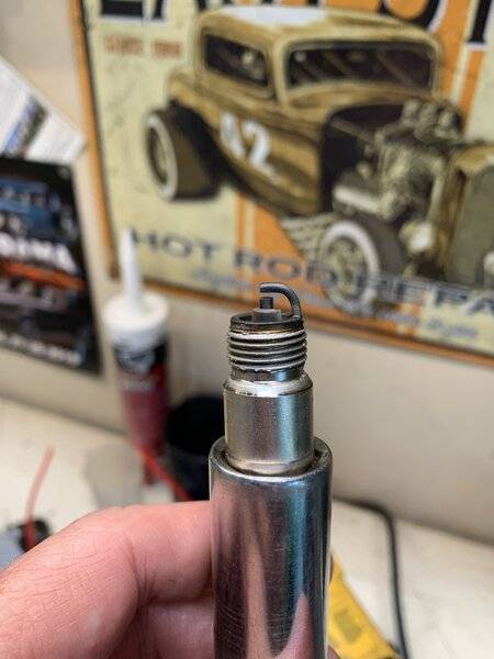

Back at it today. So frustrating. 90 outside. Added an in series trans cooler. Still 210 on highway. Swapped my primary jets from 62s (13.2 afr) to 65s thinking I’m lean at cruise and since my plugs were white (cars faster but not cooler). Once it gets to 210 it just can’t get back down. It starts at 195 on highway but increases 2 degrees per mile. Under 50 mph it’s 180 all day long. Got home and trans cooler is warm to touch but not hot like radiator. I guess the new 12x12 trans cooler is blocking some airflow??? I guess I’ll completely bypass the radiator tonight as others have suggested and see if temp comes down. If not then what? My radiator is a 1 year old champion 3 row 26”. That’s all I have left to replace!Update. I think I made progress?
Previously at 84 degrees outside:
Idle to 25 mph- 195 degrees
on hwy at 70mph- 208 degrees
today 90 degrees outside:
Idle to 25 mph 182!
Highway 196!
However, I got off the highway, sat at a light, put the car in neutral thinking the pump would run faster but the temp soared to 212. Took 2 miles at 45 to get Back down to 195, then in my driveway back down to 190.
Seems to cool down faster in gear vs in neutral when stopped. Normal?
here’s what I did:
1. Replaced the 440 source water pump housing with the original RV housing.
2. Put the Milodon 180 thermostat back in.
3. Installed the Napa stock water pump.
Definitely improvements noticed especially with hotter conditions outside.
