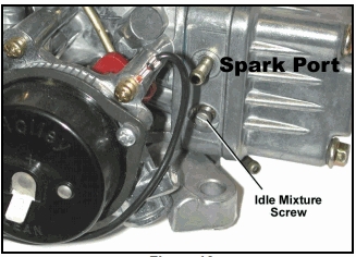

If the car idled down after you took off the vacuum advance hose the the hose is connected to the incorrect place on the carburetor. The vacuum advance should be connected to the "Spark Port" of the carb which is the port in the metering block. that port dosn't have much vacuum until you rev up the engine. Carb.jpg
65affair: If you do a search you'll find a really good explanation as to why the vacuum advance should be hooked to FULL manifold vacuum, not the timed spark port as you suggested. Not talking about a stock smog motor, but a performance motor.
