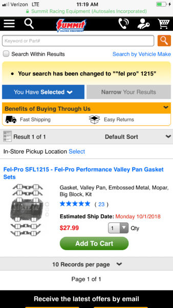

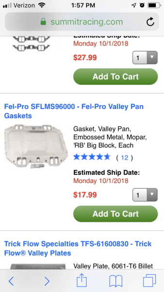

I’m looking at this one but I don’t want the heat crossover holes. I live in Florida. Is there one without or just make thin metal patches?
It's FELPRO #1215 that has the heat riser blocked.
