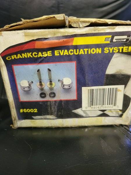

run your cover breathers to the exhaust system through that pcv away , that really pulls the crank cast and sets the rings down on the pistons , much like a vac pump .
I like this idea a lot, especially for the off-road scenario that this engine lives in. I ran traditional filtered breathers for awhile but the dust accumulation in the engine compartment is bad enough without adding oil for the dirt to stick too. Probably going to weld some ports to the header and and let it do its thing. Great suggestion.

it works great , make sure your tubes in your exhaust are cut on an angle on inserted on an angle . it all helps draw out the pressure . my boss 302 was modified a bit , lol . and the only way i could get it to stop blowing the dip stick out of the tube was this system to suck the crank cast free of pressures

I ordered the moroso evac kit to the headers, my neighbor has a similar set-up on his 63 nova running low 9s and its very clean.

What makes you think it was an intake backfire? An evac kit will not do anything to stop what you call an intake backfire. All that kit does is help evacuate crankcase pressures which I believe you have a lot of.
