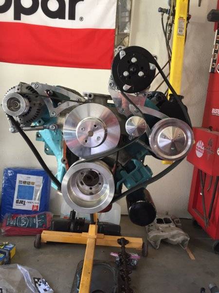

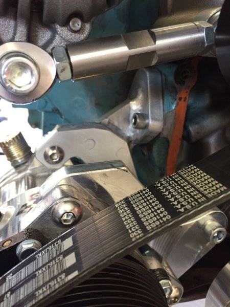

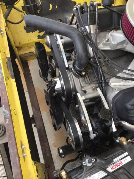

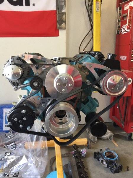

The CVF Beast serpentine kit is modified from its original belt routing along with putting the ac compressor down low on the passenger side. I was able to reuse 1 belt and had to order a shorter belt for the crank to power steering pump and that will be here tomorrow. Also scored an ECP 2 row, 1 inch tubes, 26” radiator on eBay for 140 smackers. I will probably have to switch to electric fans due to the lack of space in my 69’ Dart GT, we will see.

Lucky bastard, were they new rads?? I just talked to frank at ECP yesterday
That looks much better! I never cared for the compressors sitting on top, very detracting....
It is a new radiator, has a bent flange, no biggie to fix it and comes with their warranty. Couldn’t pass on it!

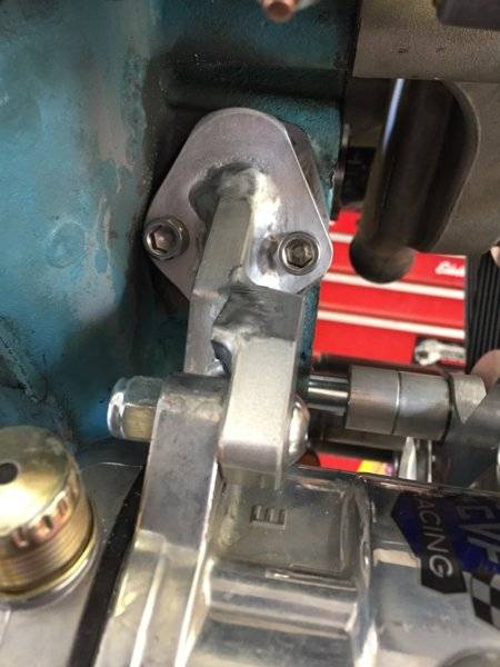

Yeah, the ac compressor on top looks like an after thought. The bracket I had to make was simple, but getting 1/2 aluminum to melt was hard, had to put 140 amps to it.

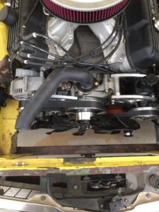

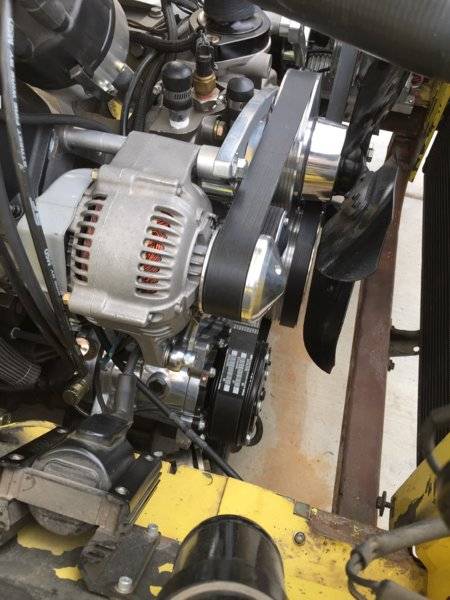

The Beast from CVF Racing is installed, modified and waiting on the shorter 8 rib belt, the 6 was dirt cheap and good for mock up.
If I can get a different power steering pulley, I can make this a true 1 belt serpentine set up.
