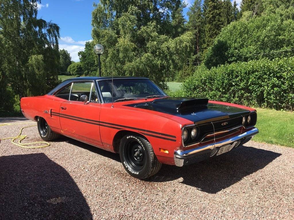

Hello.
I am new here at the forum.
Living in sweden and have a gtx 70 440 with 8-3/4 3.55 727trans, power brakes
I am going to build up a new 440 stroker and new some advertise about how to build it up.
Hughes stroker kit 493 0.30" 69block
Edelbrock 60925 84cc
Edelbrock performer rpm intake
Holley 850carb or 950?
Harland sharp 1.5 rockers
High volume oil pume
Pro billet dist
Msd 6al
Compression ratio?
What camshaft should i be use roller solid or hydraulic? and converter? Street driven car and a red light racer on the street, i just want to go around and do burnouts and maybe do a simple strip once or two a year
// Pontus
