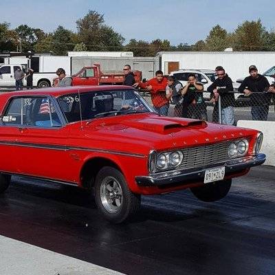

Myself I run the Indy dual plane intake on my 493 and I like it. Its like the RPM intake but has bigger ports and runners. Using an 850 DP mine has run 10.70's through the full exh on pump and driven to the track. On my cam I went with a custom flat tappet from Dwayne Porter and it is 264 & 270 @ .050 WITH .585 & .592 LIFT AND A 110 LSA. I have it on a 106 ICL. Ron
--------------------------what gears and tires? what weight ?
I am running 4.30's using a 30 x 9 tire. Car weighs right about 3725 lbs with me in it. I turn about 3200 rpm at 60 mph on the highway with my 727 and a Dynamic 9.5 converter. Ron
