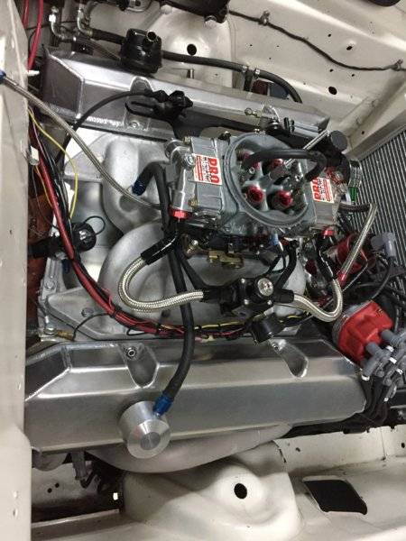

Personally i would use the Dual plan RPM manifold and port it, on the street its gonna be Great and yes some track will be just fine, i went 10.36 @129 in the 1/4 with match ported Dual plane intake & RPM Heads on my 440, if you have power brakes i would consider a hydrobooster, not vacuum. regarding your Cam Choice yup talk to a tech.

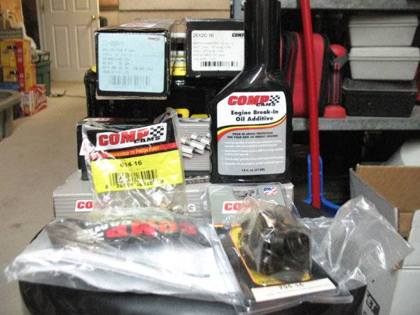

I have a complete custom spec comp cam solid flat tappet package from Dwayne Porter for a big block stroker BNIB . This was for a 68 Bee 496 ,373 gear ,3000 stall . very strong midrange where you want it . cam spec valve lift .571 in ,.579 ex , 255 ,261 duration @ .050 110 lobe separation ,includes EDM solid lifters ,beehive springs ,retainers ,locks ,and 3 bolt chain and gear
