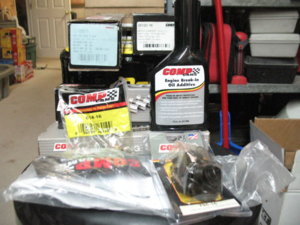

Comp came back with the 286HR-10. I am going to contact a few other places as well. Howards has a cam almost exactly like this as well. I have considered something as big as 242/248 @.050 as the 3.55's will likely become 3.91's if I can swing a Gear Vendors in next year or so. I have all but decided to stick with the 1.5:1 rockers. Also talked to the guy that I am going to have assemble it and he said should be able to get it in the first of January. He also thought the girdle and studs would be overkill for what I do, which he actually knows me, which would save the need for complete disassembly (the short block is assembled) and all that goes with that. $500 for a full day of dyno time? I don't know what the typical rate is, but he figured it would take maybe a half day to get it dialed in with setting up the test and self learning EFI leaving most of the tuning to timing.
