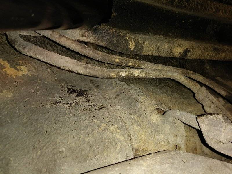

So here's one that doesn't seem to be the norm when it comes to fuel systems of the day. Had the 68 Charger R/T numbers matching 440/727 since '87 with 77k miles at that time. Never touched anything with the fuel system basically from the pump back to the tank, nor did I have any issues with it. I would like to eventually replace the original tank and lines at some point, but knowing I have 5/16 fuel line (measured .32") with 1/4 return I cant seem to find a sending unit with that same setup, only 3/8 with 1/4. The underside including the tank and fuel lines still have the original undercoating on it as well as the crimp clamps so I seriously doubt it was ever changed since day 1. My question is--is there a 5/16 sending unit available with a return or am I looking at getting a 3/8 unit, 3/8 lines and a new 3/8 inlet stock pump? I only have about 100 miles on the new engine so I'm hoping I don't need to toss the pump already, especially having everything recently restored to factory appearance. Since the sender still functions great I guess I can always reuse it with a new sock and retain the 5/16 setup.

I believe that the 68 -69 440 cars had the 5/16 fuel line with a 3/8 sender with the return line. The parts books that I have seen show the same pickup as the hemi for 440 cars starting in 1968.

Thats the way my 69 RT Charger 440 is set up it has 5/16 fuel line with a 1/4 return line and has a 3/8 sized sending unit. The short chunk of rubber hose off the sending unit absorbed the size change. Its kind of an odd ball setup if you ask me.

Ok yes it seems odd that the factory wouldn't have everything uniform with respect to sending unit outlet vs hose size. Thanks for clearing that up. I guess I would have eventually discovered what was used once I have it apart.
