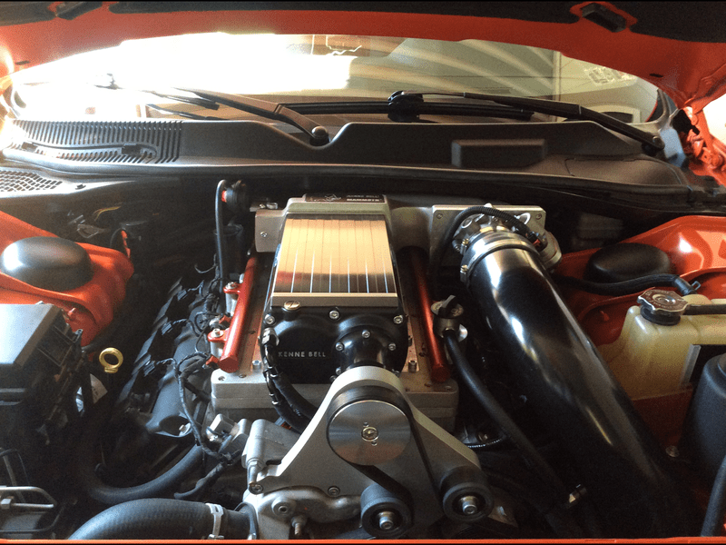

Gotta get this in. The KB Blower brought the 5.7 to about 500 at the crank from 380. Transformed and trouble free. 2.8. Twin-Screw. Liquid Cooled.

View attachment 1186495 Gotta get this in. The KB Blower brought the 5.7 to about 500 at the crank from 380. Transformed and trouble free. 2.8. Twin-Screw. Liquid Cooled.
I like that but I don't think I would supercharge this car but I have thought about putting one on my 2010 Challenger :)
I am putting a 6.4 cam and TTI headers on this one though.
