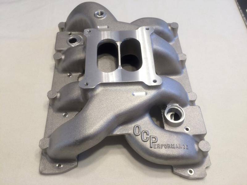

If I was gonna go carb, I like the OCP duel plane intake.
Most carb intakes are single plane, and thats fine, but in a truck, or street car, IMO, I like the extra torque of the duel plane.

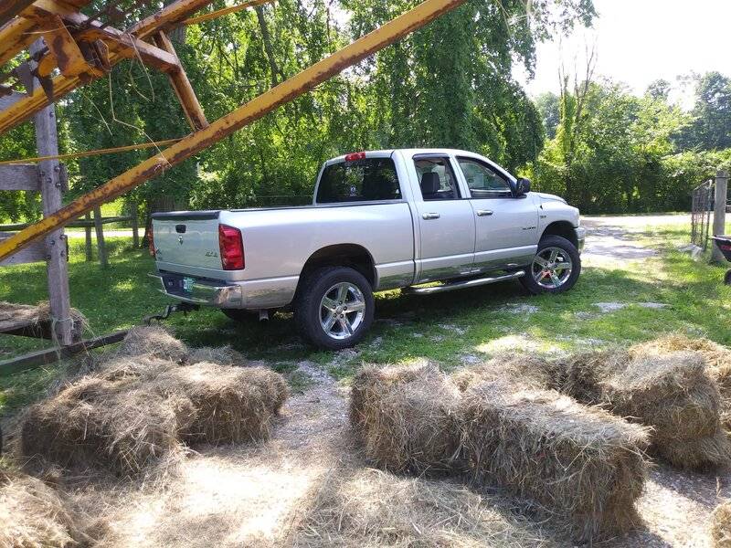

I have this truck, seen yesterday pulling an empty hay wagon. 2008 Ram Big Horn 5.7 Quad cab. Automatic. 4x4.

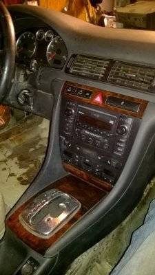

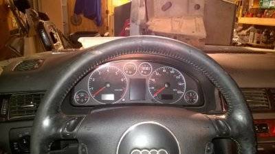

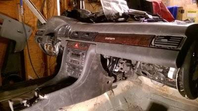

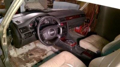

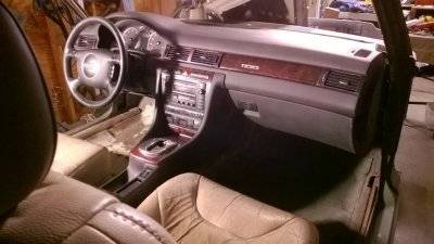

I guess I thought that everything that's in the truck now that makes the HEMI & trans work, would be swapped over to the Express, nothing extra needed. My car has a 2004 Audi A 6 dash, complete. I figured all of the wiring and controls units could be brought over and incorporated into the modern dash. The only thing I thought would need to be modified would be the K frame, trans mount, and possibly floor pan tunnel. Am I wrong? I'm not needing to marry the thing to a 1967 dash.
The drive train from your ram would be a great swap to my 77 Midnight express/Warlock clone.

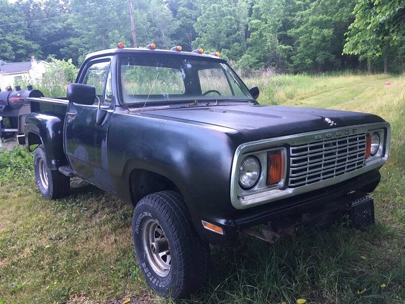

Here is my truck, it is being worked on when cash permits. It runs fine and I use it now, but its a work in progress, I just added the cab roof lights. I have the stacks, and wood bed kit yet to install. I was holding off on the stacks till the Hemi gets dropped in, as the previous owner just has new duel exhaust installed.
Any photos of the dash your talking about?
Yes. My build thread is in the Restomods section.

There's a build thread on here for a 70 Plymouth where he tried to use all the oem stuff, dash and all from a 300c. He ended up with hotwire harness. It's worth the read, many years old but shows the difficulty with just oem stuff even when you have the whole donor.
Thanks!
That would be my thread "B Body Stiffening" in the Resto Mod forum. The BIGGEST issue with these new Hemi/auto trans package swaps is the speed sensors and tone rings. Without them the transmission won't know what the engine is doing so it just limps. After market TCMs are available for this via "www.soundgermanengineering.com". i discuss all of this pretty good in my build thread. The last entry I made a few weeks back tells of how well the car has performed, check it out!
If you do the modern dash or not, this will still be the same problem. I do discuss my problem with using the complete harness and the instrument cluster from an 07 Charger
