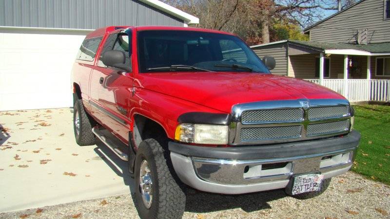

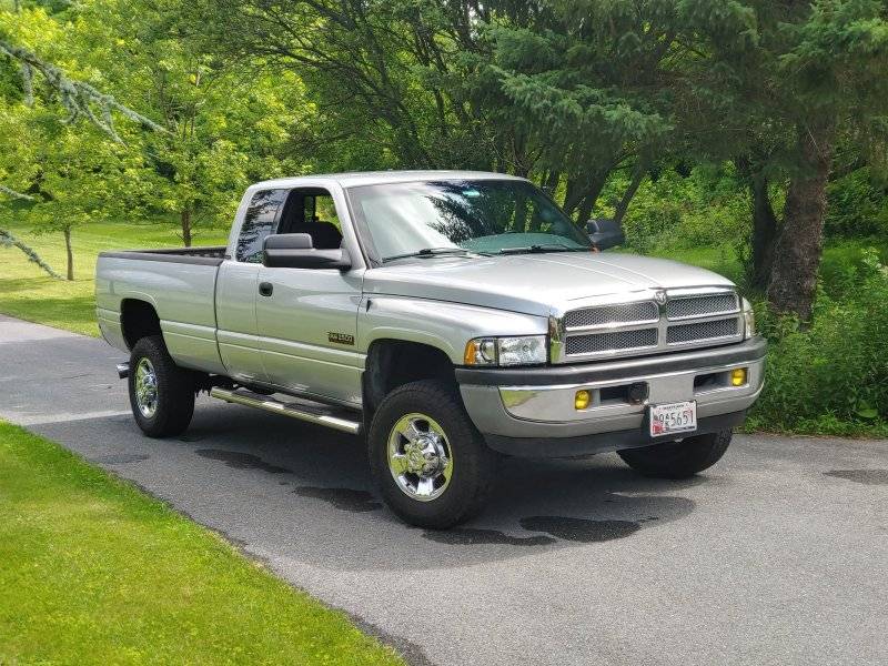

What a nice truck!
I live in the salt belt in WI. That truck would sell for $20k+ here.

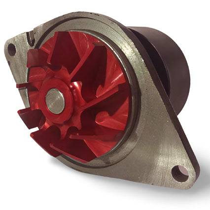

Well...installed the FlowKooler on Sunday. Rainy and crappy Monday, so no shakedown run to work then (wouldn't be able to see any leaks on a wet parking lot). Dead battery yesterday (left my cargo lights on, duh). All charged up now, drove to work today. Normally the temp would hit 190 easy on the way to work (20 min run through country roads) - not today! Barely cracked 150, and that's with the cold front 3/4 closed (more like 5/8 closed, actually). DEFINITELY flowing better!
The old one, once I had it on the bench and could check it out, had a bearing failure. The pulley and shaft have a LOT of wiggle to them. Doesn't look like it was enough to cause the impeller to hit anything (no marks), but it really wobbles. Hopefully this one will do better. I do remember when I installed the last one, I also installed a tensioner because the old tensioner was notchy/crunchy and when the engine was running I could see it "clicking" through positions. Hopefully it isn't set for the wrong tension, and that's what killed the last pump...but we'll see.
