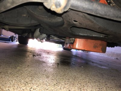

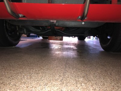

OK, I have been perplexed by this for sometime. I recently put a 505 stroker in my 68 Charger. It also has a Moreso oil pan which definitely looks high capacity - like 7 quart but not sure. For what it’s worth the engine build also specifies a 3/8 Oil Pickup and Melling High volume oil pump.
I’ve been under the impression my car is burning oil but now I’m wondering if 7 quarts has actually been over-filling it.
When I change the oil and put 7 quarts the dipstick registers full. But then I would smell burning oil as I drive and would see puffs of smoke when I get on it.
Eventually after a couple hundred miles I stop smelling the oil and the smoke goes away. Dipstick now reads “add” - less than “add” but it is now running strong and clean. When I change the oil 4-4.5 quarts come out.
Had the compression checked and it’s fine. I am figuring it only needs 4-5 quarts and is burning off the excess. Even though the pan may be bigger than stock perhaps my pump and pickup are offsetting? Also it seems I need a longer dipstick? At the time of oil change 4.4 quarts come out yet it was registering nothing on the dipstick.
Thoughts?

That’s at least a 6qt pan, looks similar to mine and it’s a 7qt. Are you running a windage tray?

4.4 quarts drained plus .8 ish in the filter is far from t he 7 you put in. Something isn’t right.
the last time I did a fill test on one of those pans, IIRC, they more like 6qts than 7qts. the problem is the sump is short length wise. this lets the pan maker have a one size fits all. but, even at that I think your loosing oil some place. could be a leak, intake not sealing, rings, valve seals, etc. going down to 4-5qts is probably dangerous in a performance engine.
Pull a plug and have a look. It should be obvious if it’s consuming oil. It has to be going somewhere...
Engine has issues. With filter that’s a 7qt or close to it oil change with that pan.
What crank is in it, if you know??
as others have said a windage tray is a mandatory part of a performance engine. i use that pan on my stroker and 8 quarts total with no problems. your stroker is bigger than mine if the builder of the engine did not under stand how much turbulence is in the oil pan just at 3500 rpms then i hope he did everything right.is the dip stick in all the way ? if you look at the pic of my car you will see the oil pan hang down it is black so look close.

If you're losing a couple qts of oil between changes, with no leaks, then it has to be burning it. This is evidenced by the fact that you see blue smoke for the first few hundred miles, then it stops. Most stroker cranks have the counter weights made to clear the block. Even my 451 only had .125 taken off to clear it. So that is going to have a minimal effect on oil whipping up. Need to see if you have a windage tray, I would pull the pan and check that. Oil level height is measured at dipstick, no matter if you have a 5 qt or 10 qt. 7 qt pan shows full when you add 7 qts ? You should be ok. Sounds like the builder may have put in too much rod journal clearance, throwing extra oil on the cyl walls, or low tension oil rings, no windage tray, or all of the above. Run it awhile, then take it apart and inspect the clearances, rings, etc.
Should be able to tell if it has a tray just by looking at where the oil pan rail is, it will look like a thin metal gasket between the oil pan and block.
My 512 has a 4.25 stroke crank, and doesn't smoke or burn oil. And it goes to 6500 RPM or more quite often. Milodon hi volume external feed pump, with a windage tray. A longer stroke crank may need a special tray made for that, mine does. Find out your exact stroke. Is it 4.15? I think that's what a 505 has. 400 block? You could also try a higher viscosity, 20W50 oil. What are you running now?
