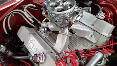

My 66 Coronet was a 505' (Only .030 over, not .060 over to make it a 512"). I used an Ohio Crankshaft Assembly with their H Beam Rods and their SRP supplied forged pistons with 12.2-1 CR. (you could go 11.75-1 probably and not lose much and might be easier on pump gas), Motor had 440 Source Steel Billet Main Caps and 440 Source Girdle.I had Comp Flat Tappet cam with about .650 lift. 440 Source rockers with 1.6 ratio. INDY Max Wedge heads ported to 340CFM from the regular CFM of closer to 310CFM. Dougs 2" headers with 3.5" collector. MSD Dist, of course. Indy single Plane 4500 Intake with 1050 Dominator. MSD 6AL box. Dana 60 with 4.30 gears and Hoosier 29.5 tall,11.25 tread with Bias Slicks. Calvert springs, bars and 9 way shocks and front 90/10 shocks.
5000 flash converter to my A&A Torqueflite. PRETTY BASIC STUFF. Ran consistent 10.15 and 129+ but as low as 10.04 @131+ with some good air. Ran 110 race gas at the drags.
And....absolutely streetable, drove it to car shows and hot dog stand get togethers all the time (thru Flowmaster Mufflers).
With the ET's and MPH my car was running it had to be making about 750HP.
When I originally built the motor it made 602 HP but had standard port (not max wedge) heads that only flowed 290CFM. I also had 1 7/8 Hooker headers, INDY dual plane intake with an 850 Demon carb....it ran 11.00 flat.
With the head, intake manifold and carb upgrades it went 10.04.
YOU DO NO NEED NITROUS TO DO WHAT YOU WANT.
Go with Max Wedge Heads, bigger cam, big headers, Single Plane 4500 intake and 1050 Dominator to start...don't start smaller and then spend the money to upgrade later.
I guarantee your car should run below 10.25 with this build similar to what mine was. I did all the planning for you when building and testing my car...no reason for you to build the lesser motor you described in your post above.
PS: don't worry about running a 1050 Dominator on the street, it runs just fine...no need for the fuel injection system. The Holley 1050 Dominator SP carb is only $810 on Summit.
