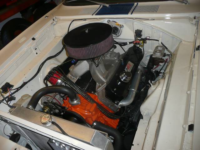

Well they used a 2" pipe on their head machine when testing the 270, but yes 1.7/8" hdr would be somewhat restrictive for such a large motor. On our RR the hdr (4" collector) is adequate but he only runs a 2.5" exhaust through to the rear cos thats what he had when a 440 and thats how its run@the track, I worked out from our weight/mph is only around 20>25hp loss according to the dyno numbers but he is chasing 10ths NA your not? and you'll have N20 which is going to be interesting with the stick. I reckon you could get away with a 2">2.1/8" step hdr which actually is what we have I think?..not sure, I was told but can't remember.

Oh, now I understand, you were referring to the flow bench so to speak.
I have electronic cutouts, and a 3" exhaust system, so with my current 440 6bbl, I don't notice much difference in performance, but open headers sound great. No, not chasing 1/10ths. I will see about the header change when the time comes. Nitrous may never happen, but I'd imagine if I do it will be only under certain conditions, not the whole 1320.
