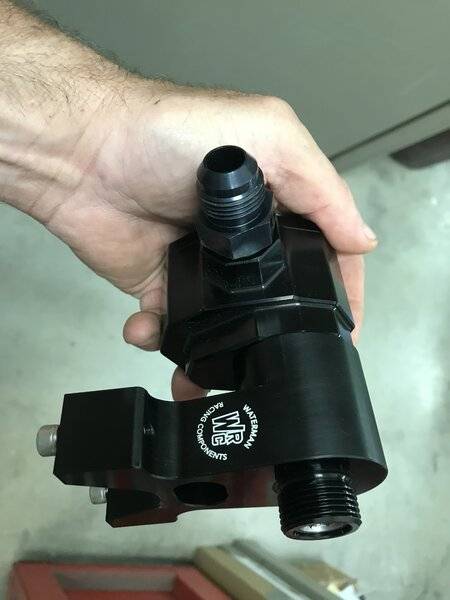

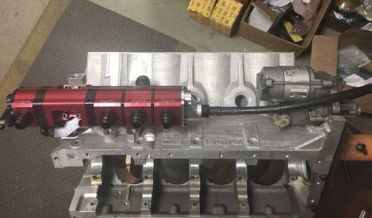

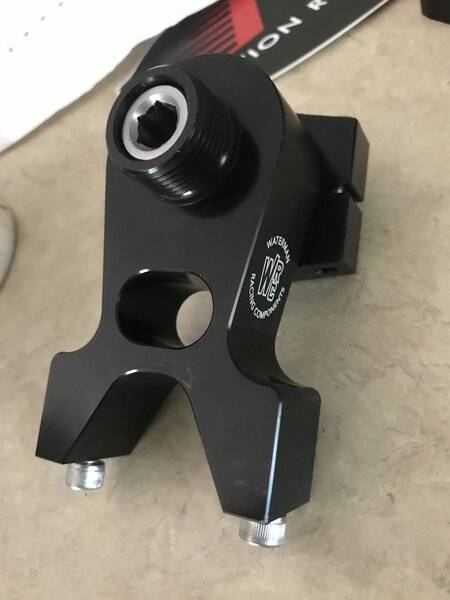

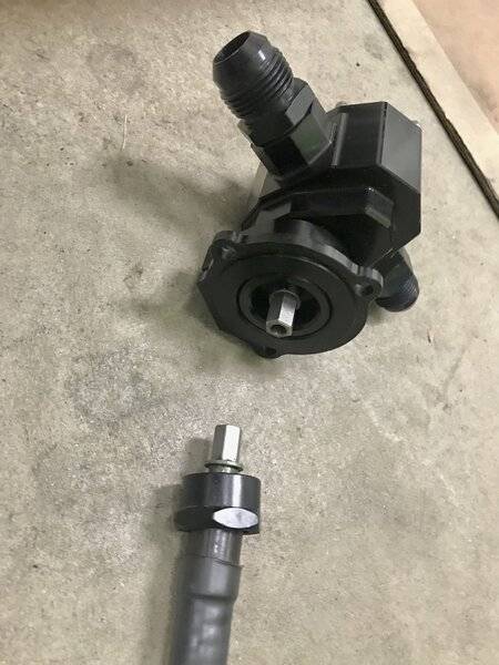

So far so good, but this doesn’t have a lot of miles on it yet. It does have a dozen or so 1/8 mile passes on it driving the dry sump which in turn, drives the mechanical fuel pump.
0D8098EC-EE90-415D-8F26-BE1D03417D35.jpeg 29047AD6-92EE-45FB-975E-1FE2878170D6.jpeg 82EC2BEF-CD98-44A9-A5B1-CEDCFC9FB941.jpeg 7A2B490C-2B61-494D-A9D9-A48A18C6B7AA.jpeg
I'd think those 2 items would be more than a HV oil pump, no?
I’ve never set up any tests to measure the torque it takes to turn any of it. Just rationalizing it all, I can’t see a HV pump over a standard pump being enough additional force to cause a gear failure.

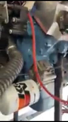

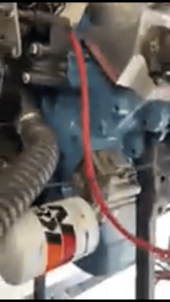

Looks to be a factory iron 440 block. I don’t know of any aftermarket aluminum blocks with these two bosses cast on.
I grabbed the first 2 videos I could find easily. When I saw the painted block, I thought that someone may say something, and, well...
