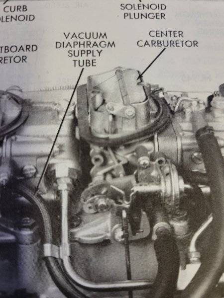

I thought the end carbs were supposed to run 1/2 way up the sight plugs... or was that just the 340s??
I just had to dig in a manual... take a look at the sight plugs. They are indeed lower than the center as I thought.
When I set up a T/A 340, I remember reading to use clear sight plugs on the outboards, and put them half way up. This was some kind of performance bulletin, but that was a long time ago.
Anyway, that car has always run well with that tune up.
All of this makes sense, when the complaint is having to crank the needle&seats too far...
All of this makes sense, when the complaint is having to crank the needle&seats too far...View attachment 1349668
Yes it was in the Bulletins and common with racers. The reason was to initiate the fuel delivery sooner with less signal. The goal was to open outboard cars at the fastest rate while minimizing the lean hole created when they started to open.
Keep in mind the OP does not have OEM end carbs. The manual and likely the bulletins probably don't apply to the aftermarket mechanical end carbs.
