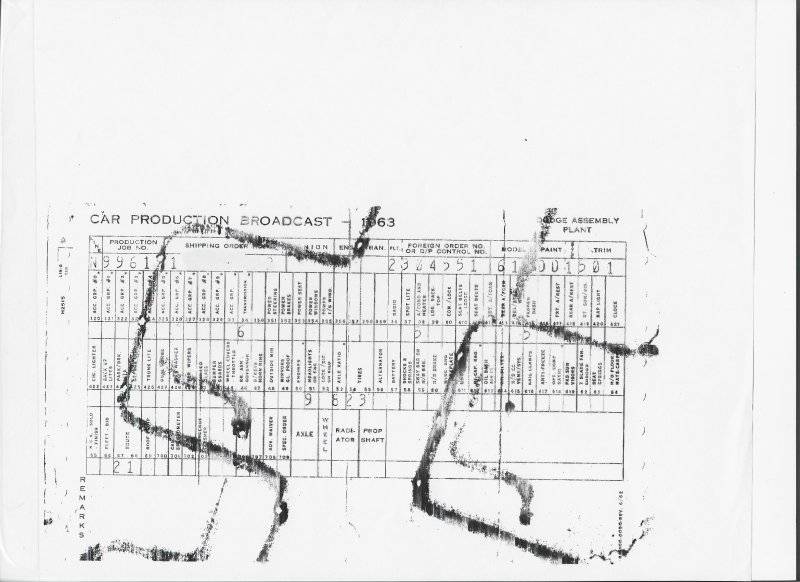

not all 63s with hc motors had alloy fronts with scoops but in 64 the only way to get hc was the alloy front on max wedge cars here is my old steel nose hc stick car and the paper work when new and the build sheet
1963's were already out by Nov. 1962. Traded in a Chevy; good choice. LOL.
It says, to be delivered on or about, DEC 63.
That's what I can make out on there.
I know, doesn't make sense.
