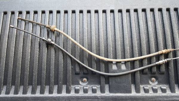

Dorman parts lists rear cable part no C92205 with a conduit length of 20.07" and cable length of 29.41". Question - By cable length, do they mean how much cable protrudes from the conduit which is in my case around 29" (or overall cable length end to end, which in my case is around 50")?

Well the conduit lenth and cable lenth you posted add up to almost 50". So the 29" must be what protrudes.
I would think that these cars are all going to be pretty close in lenth for the rears. I know both on my '62 are the same.

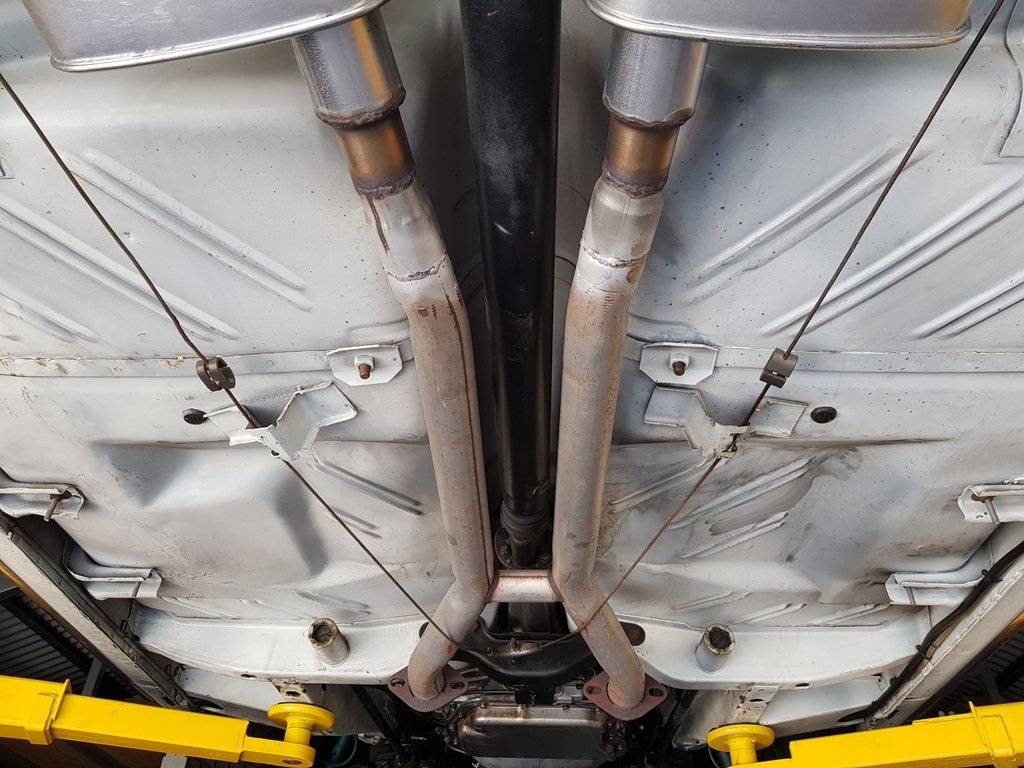

I converted my 65 Dodge to the 66 and later system to get away from running a cable under center of car. I see 62 Dart conv has the double holed bracket for rear cable. I mounted a bracket for front cable to the trans crossmember. Made a rod to connect front cable to the e brake cable connector. No cable going over exhaust system.

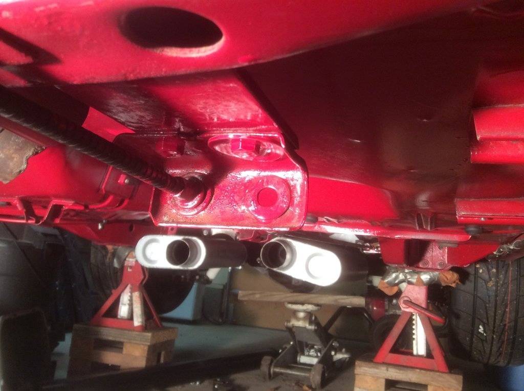

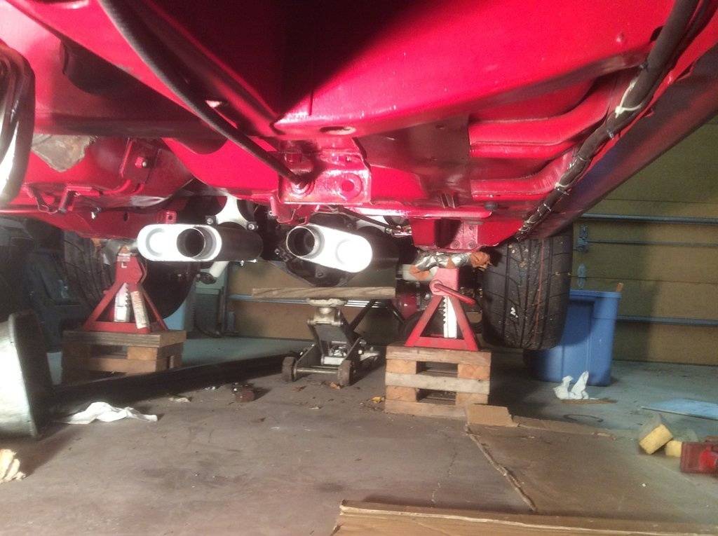

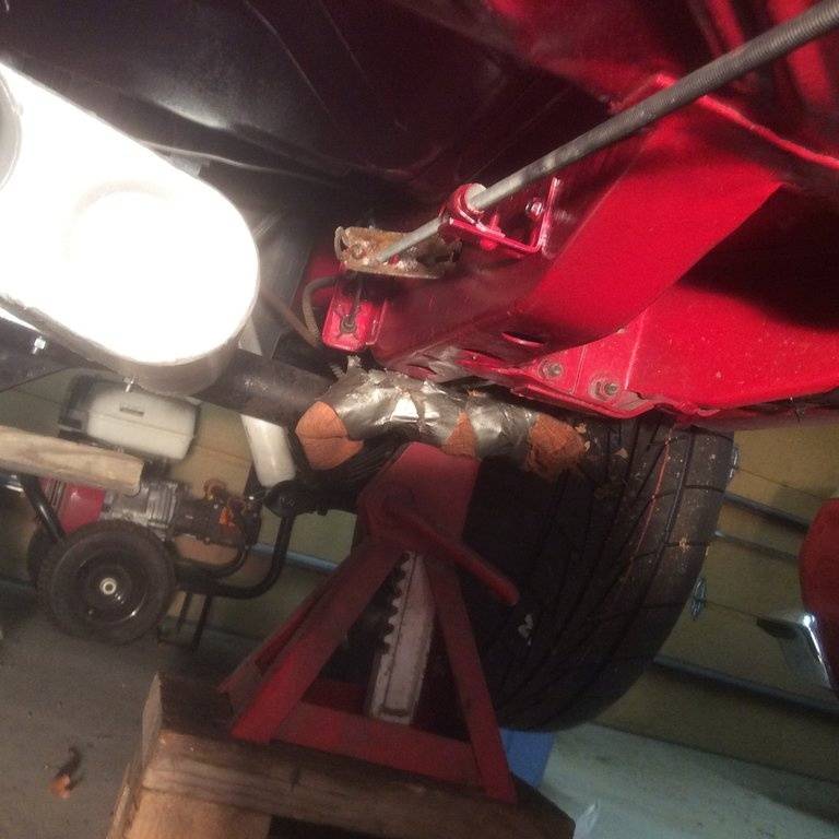

So do your parking brake cable lengths/layout look similar to mine KK?
I converted mine to the later setup.
In picture you'll see an l bracket where rod from front cable goes through. On the l bracket is a 1/2" fuel line clamp with a 3/8 piece of plastic pipe inside. It holds the rod up and allows the plastic pipe to slide easily. It's a little ham and eggie but works. I'll have to look into why the rear cable bracket is horizontal. Mounted front cable to a bracket on the trans crossmember. Mounted a rear cable bracket to a piece of angle iron and that was bolted to trans crossmember. Used a connecting nut and jamb nuts to connect the front cable to threaded rod.
Well my worst fears came true - I finally went to fit the rear brake cables to find that Dorman C92205 which are listed as for '62 Dart DO NOT FIT. Will Rockauto accept a return beyond 30 days? I'll find out....
https://www.dormanproducts.com/p-11081-c92205.aspx
They shouldn't have them listed as fitting a '62.
Yes that is now clear. The NAPA part you linked to in post 4 also incorrectly states it fits '62 Dart.

We need to find a total cable lenth of around 50" for a start.
I ordered them as I wanted to replace the original rusty looking things with nice shiny new ones, not that it was entirely necessary... turned into a cluster F#@K.
RockAuto refused return as it has been longer that 30 days. C@#%S.
I'm on it. All of the adds that I'm seeing say for '62 and they are not right being 29". You can even see in their pics that there isn't enough cable showing out of the housing. Now for around $300. I've seen a complete kit with all the cables and they kind of look right. I don't depend on pictures either though.
