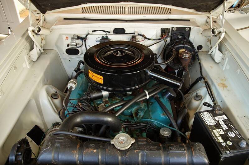

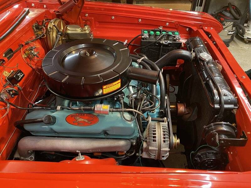

Put on your concourse judging hat for me. Aside from the brake MS, what else can you see that is not correct for this 62 Fury, 361/4 engine bay? View attachment 1200981View attachment 1200982View attachment 1200983

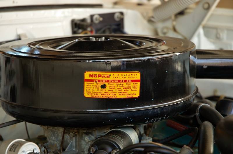

Nice reference piece! Is that an oil bath air cleaner? It just looks bigger than regular dry filter air cleaner.
Yeah, that's my wheelhouse, too.Dave I'm not sure on the air cleaner....I go as far back as 64....

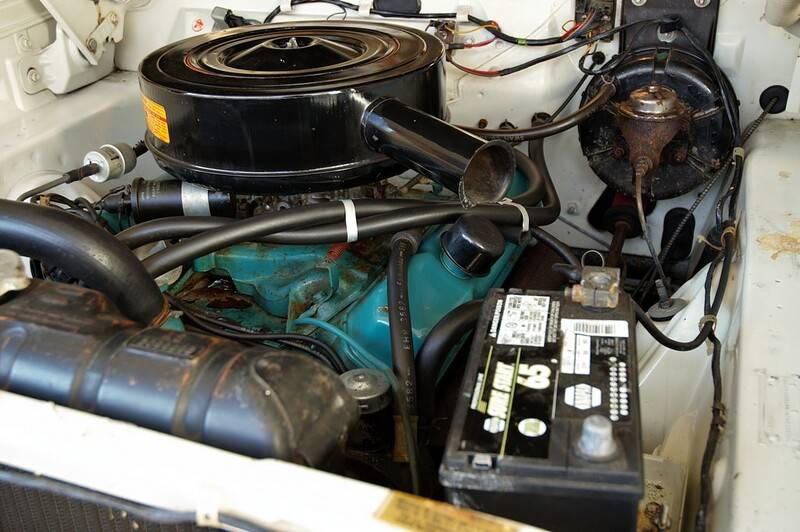

Very tidy looking engine bay, Stumper. I am going to nit pick, but you challenged us. I am comparing your engine bay to one in a road test of a 1962 Sport Fury. This is from Motor Trend, April 1962. I will qualify this by saying this may be an early production car and may have small differences from regular production. Motor Trend had their offices in California, I think, and this car could have different emissions equipment, even that early.
I notice a dual pulley on the alternator, which would be seen on cars with AC. I have never seen a big block with your configuration of water neck (thermostat housing) and upper hose. I am used to seeing the water neck angling forward instead to the left (driver's) side. The upper hose usually angles right to a water outlet on the far right of the radiator tank, as shown in drive test.
The test car shows a plastic bodied fuel filter, rather than a metal one. That same picture shows a rubber hose from what must be a pcv valve to a fitting on the front of the AFB, instead of a draft tube. Again, this could be a California thing.
The fender and other attachment bolts should be painted body color. Most of these cars would have had a Jiffy Jet windshield washer bag and bracket. I do not see a build tag either. I did not see Golden Lion decals on the test car valve covers either. I may be wrong, but I thought Golden Lion was a Chrysler model thing. The test speaks of Golden Commando Power, but I do not see this on the valve covers either. The road test does not show an air cleaner, but I have seen a fancy small round air cleaner on these cars with a round embossment on the top front that contains a 361 decal. I am not saying that all 1962 361's came with these, though.
Please understand, my purpose here is not to bash your car, that must be equally well done. I find these old drive tests to be pretty informative of how the cars were built. I hope this helps you out, as I mean to be constructive.
