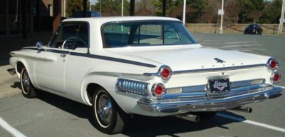

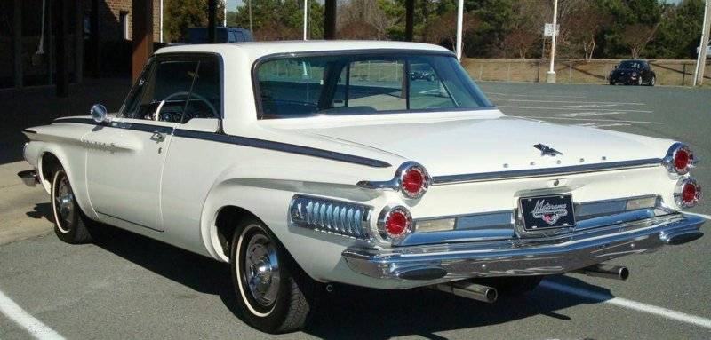

I have a 62 Dart 440, which has the round white reverse lights on top, and the red tail lights on the bottom.
I have another set of red lenses, and I would like to mimic the Polara tail lights, all 4 round red.

I think I'll go for all 4 as tail lights, all 4 as brake lights, but only 2 as directionals.
The Polara had the top as directionals, the Dart the bottom.
I think I'll keep the bottom, of course I'll have to refer to this thread to remember what I decided.

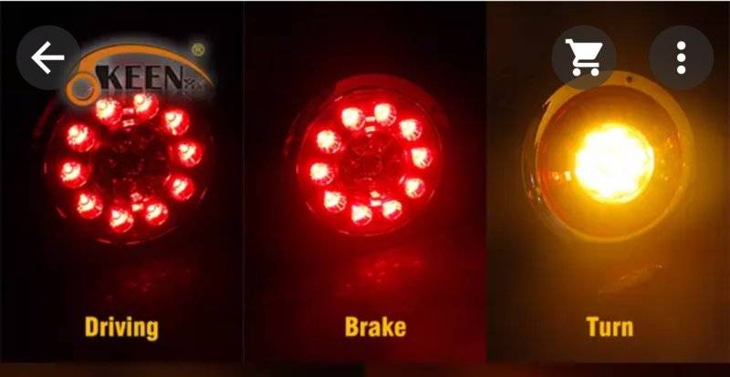

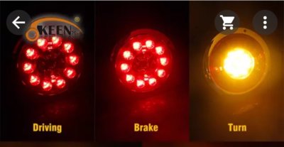

Following a range rover home today gave me an idea.
Found these, take the center out of a reverse lense and glue it to a red lense and mount these behind lense to the metal bulb housing.
Use a full red one for the other two lenses.
These are 5.3 inches with the chrome.
Could also just mount these w/o the factory lenses.
$15 for those, they also have brake with Amber turn signals for $20, and other options.
