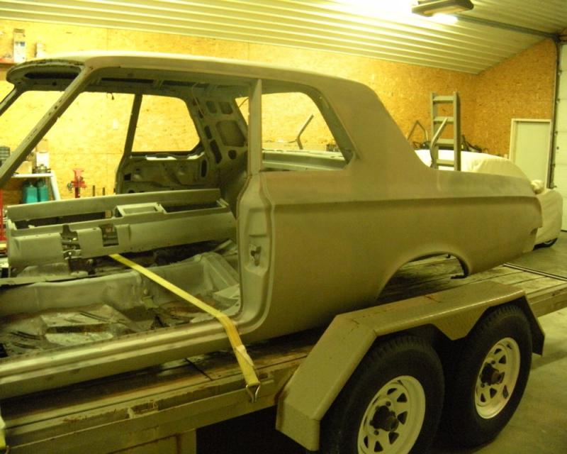

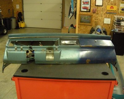

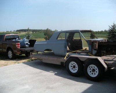

Guess I kind of answered my own question in the previous post... Anyway, here's a couple of quick shots. Some of the dash and the car loaded to take to the blaster, from which I just got back. Oh, BTW floor pans are being delivered tomorrow...:headbang:

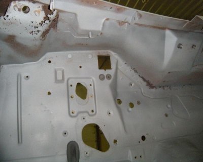

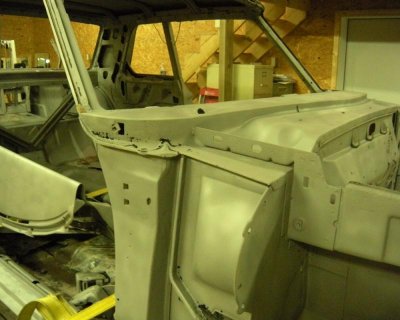

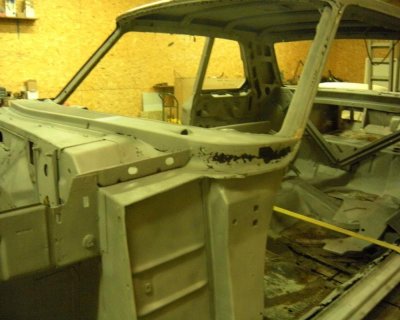

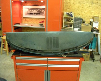

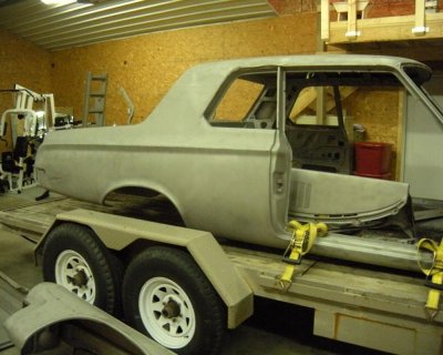

few shots. back from the blaster this afternoon. quarters look good a few scars, cowl and firewall need some attention, frame rails great, fenders have a few scars also not a big deal. dash turned out good no filler, holes or dents. all-in-all, very happy with a save-able, damn near, 50 year old 2 door post...

Do you have repair sheet metal for your cowl area? If not, PM me. I've got some good cowls that I'll sell.
stop posting pictures from my cowl! LOL
now serioulsy, this is a nice car and I am keen to see your progress
Very Nice Car...!!!! I hope you're planning on having the car media blasted. It makes the whole process of building a fine Mopar into a whole new start. Plus, rust areas will be eliminated and will show where you will need to really replace. Otherwise, good luck with the build and keep the pictures coming...!!!
Interested in watching this come together. Mostly the rust repair in the cowl/firewall area. So far so good!

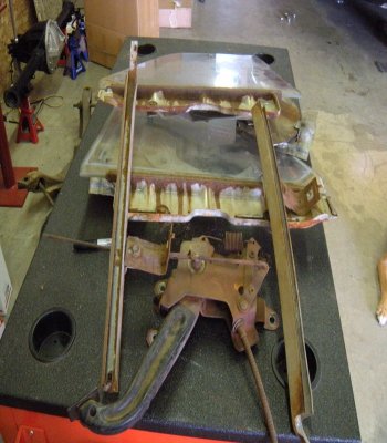

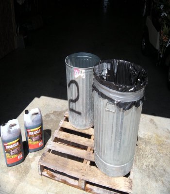

Been working on the accy side of the project lately. Interior fabric chosen, donor car on the way, working on small parts. Elephant coming along, picking up the trans and accy at MoPar nats in august. a few shots of the molasses dip started....

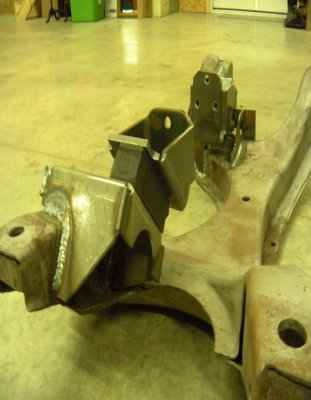

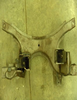

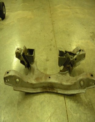

Hemi K-Member from Al Devebec. First class work...

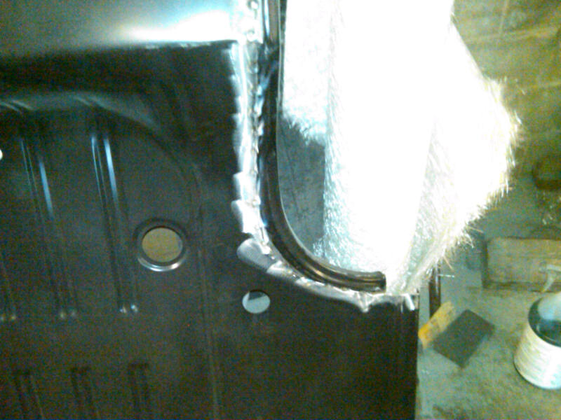

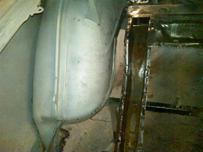

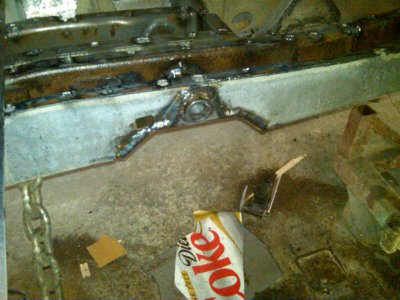

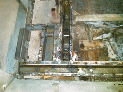

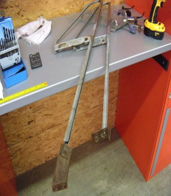

couple shots of the trunk pan removed and the new rear spring mounts. the fifth shot is the new trunk pan modified for the minitub kind of hard to make out. thats just a roll of fiberglass mat behind the shot.

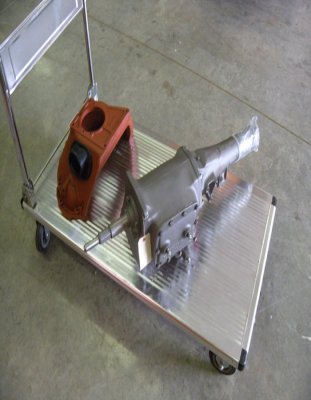

picked up the trans and all accy from the block face back from Jamie at Columbus this past weekend. Great guys.

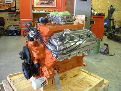

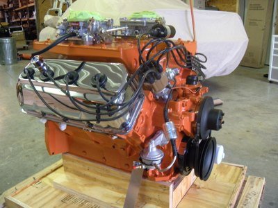

Look what the mailman brought today... Eddie Haines. Hemihaines.com :headbang:
