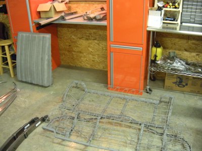

Things are moving along. I'll try to have some shots of the progress on the body in the next couple of days. Back from the second trip to the blaster. This time, donor car parts. Rear seat frames, bumper brackets, hood hinges, hood, deck lid, firewall brake plate, fuel tank, rear wheel wells for mini tub ext., etc... Oh, we also shot the test panel of the finish color today. Gerald (the body guy) looked at it, then at me, and said "Nice sleeper color". That's kind of the point... We'll see.

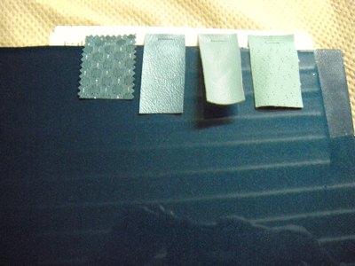

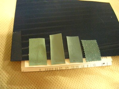

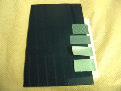

landed on the color pallet for the car. LL-1 dark turquoise exterior, L1Q factory interior code off the stock fender tag for the orig. car. Gonna do Hemi door panels for now.
Taking pictures of this never shows the metal flake or the true interior colors but here ya go... for reference the swatches go; seat fabric, main vinyl, accent vinyl, head liner. ps. i hate doing this stuff as I cannot see "tones" in colors. Luckily, darling wife gets this stuff, plus these are '64 factory combos. Y'all have a great Labor Day weekend!!

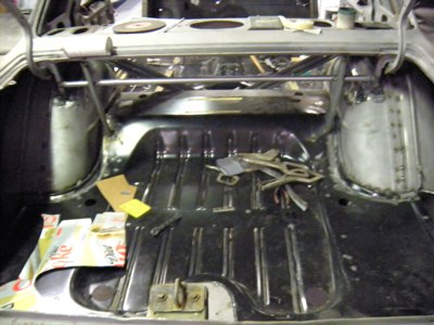

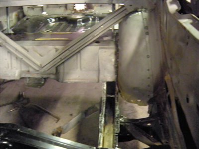

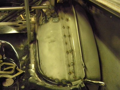

Enough of the "girly" stuff. A few shots of the minitubs tacked in and some of the trunk brackets tacked. The conduit is just support for now.

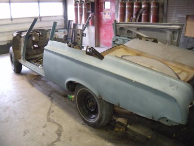

Package tray and donor car.

Thanks guys. On this one i'm not doing the heavy lifting. Gerald, of Gerald"s Body Shop, in New Paris Indiana is taking care of this stuff. I can do lighter duty stuff but when it comes to this, it's best left to the pro's. You might notice a few other projects in the back round of the second picture... I'll do the final assy. and the driveline install.

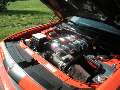

PS. my "boost" fix comes from the '08 SRT Challenger. Bored/stroked/blown 6.1 platform (426 now) just under 800 horse at 14 lbs. boost. Fun grocery getter.
Here ya go R3. Although the worst possible combo; A cheap camera and guy who doesn't know how to take pictures...

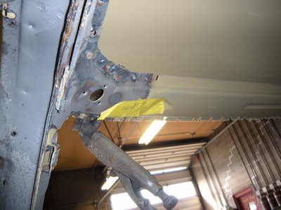

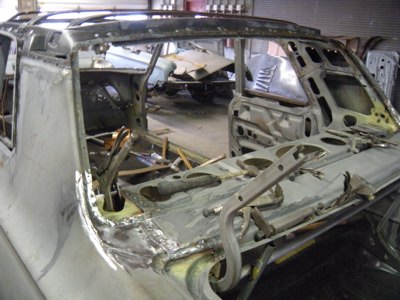

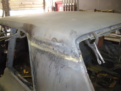

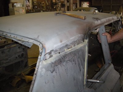

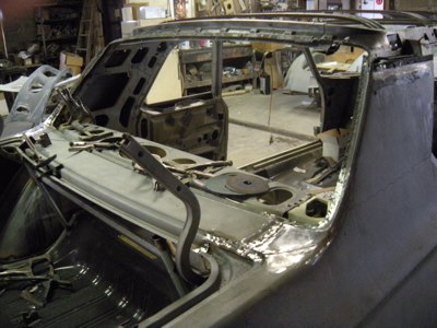

few shots of the "donor roof" clamped and tacked. like the rear upper quarters/package tray we'll lead these back in. we saved a bunch of the original lead when removing. kinda cool.

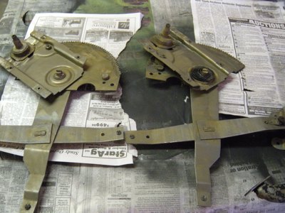

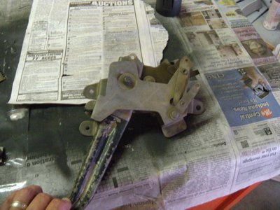

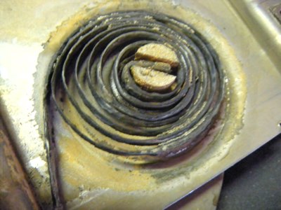

quick follow-up to the molasses dip. I cleaned and etch primed the rear window bases before i thought to take some shots but here is the emergency break pedal assy and the rear regulators unfinished. a little flash rust but that will wipe off. notice the way the old rusty regulator spring is eaten away. This stuff works, if it's rust, Its gone. the other springs didn't survive.

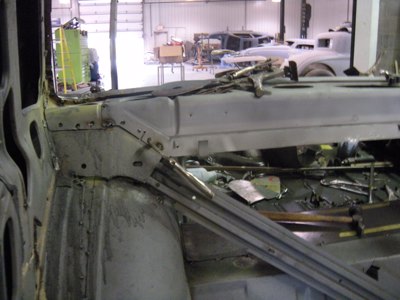

Quick shot of the shock tower flipped and the rough notch. Right now the car looks like Frankenstein's monster. I'll probably hold off on the shots until we get the welds ground and some of the filling and priming done.
