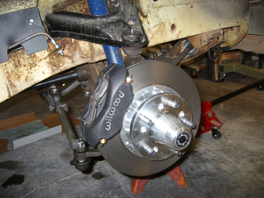

Very happy Wilwood user too - they do make a kit to fit drum brake spindles. 140-11019 (1973-80 to match later spindles I already had on her) - 14” Flex lines 220-7056
Lots of street miles and a couple of weekends at the dragstrip. I've come down from 120mph more times than you can imagine and no problems whatsoever. It's amazing how easy the car is to push around too! No brakes dragging..
