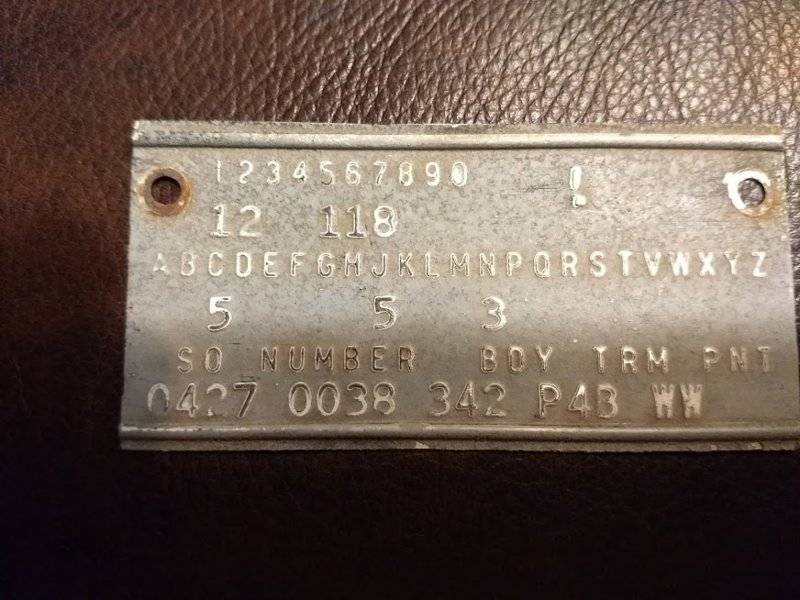

working on the car can anybody decode the vin and fender tag
vin3441229993
fender tag c5 j5 n3
other numbers 0427 0038 342 p4b ww
i would like to know what size engine it came with
If you could post a photo of the fender tag, it would be a big help...
here it is
1964 Sport Fury White Blue Bucket seat interior Auto with std heater and standard Engine 318 as no code for Engine. April 27 scheduled build date.
