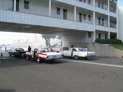

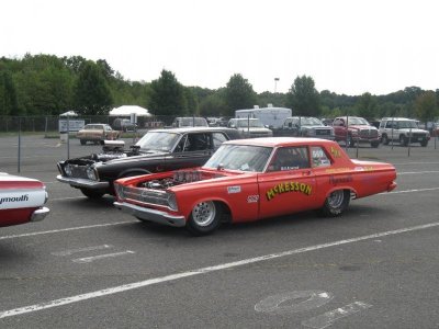

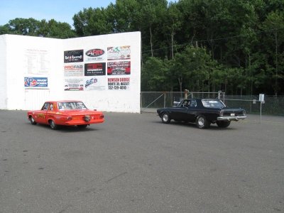

j c.jpgcheck out the book by jim schild

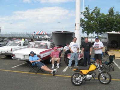

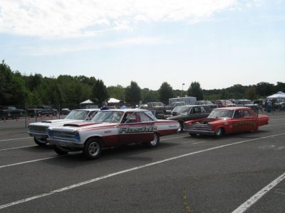

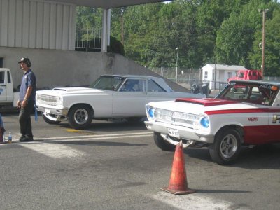

HI I have built 2 on my #3 I built flashback using the factory front suspension take look at arxer.com
we also helped steve with the vido you can contac me at 860 388 6838 thank bill

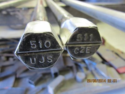

First off, good luck on your build. The world needs more AWB cars. We also have an altered and you can link to my blog below for some tips on how we built ours if you like. If you're going with moving the K-frame then you will need longer torsion bars which can be tricky (expensive) to find but they're out there. Keep us posted.

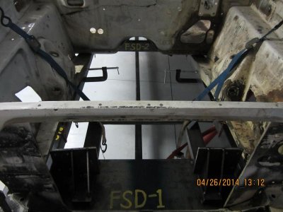

I spent 3 years and a lot of money researching the "Original" factory cars as I planned to duplicate a Coronet. For some reason those in the know are very secretive. I used Chrysler Imperial 50" torsion bars. I just milled the hex ends down to fit a B-Body. I got my fiberglass parts from sled City. I use the factory jigs for my front end. IMG_0248.jpgIMG_5708.jpg
Thanks for all the great feedback on my AFX project - spurred me to get back working on it this weeked. (My motto has been "when in doubt, procrastinate"). I had Firm Feel (I think) make a pait of the 51" torsion bars. A bit more expensive than their standard bars, but really not too bad. Just need to make sure they fit before making that last weld... Where did you get the FSD-1 and FSD-2 jigs? They sure look a lot like the ones shown in the Chrysler Technical Manual for the A/FX cars. Any other pics of your build would be terrific. Thanks again!! Steve
