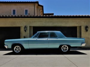

Before and after changing to 1" over arched springs. The old springs had 5 leafs and were on the car for 20 years. New springs have 6 leafs. The dimension from the ground to the bottom edge of the wheel opening increased approx 2" in height.

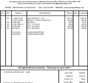

Requested a quote from Laura. She responded the same day. Followed up with a short call and placed the order. Springs shipped in 10 days.
http://www.springsnthings.com/contact-form.htm
