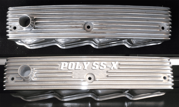

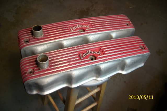

Best looking Valve Covers in the WORLD!!!:xscuseless:

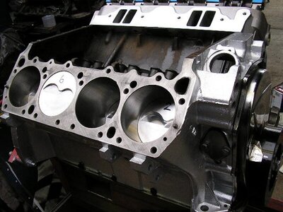

Oh yes I just remembered jellyfied pistons?
Took a 440 apart a few weeks ago AND...
JELLYFIED pistons?
Looked like some sort of acid had been put in there, but the owner said NEVER!
I should have took some pics, it was spooky...:drama:
Liquid metal pistons and bores (T-1000)

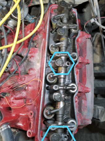

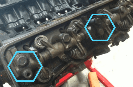

The third bolt hole is there, just not used.... First two bolt, second three bolt...
JELLYFIED pistons?
How much did it eat at your walls? Did it make the block useless?
Yes it did eat the walls and the pistons, shame really as it was a rebuilt running engine!
It needs a least three liners and new pistons now...
Some strange sort of chemical reaction that's why I thought it was acid or something to free up the rings?

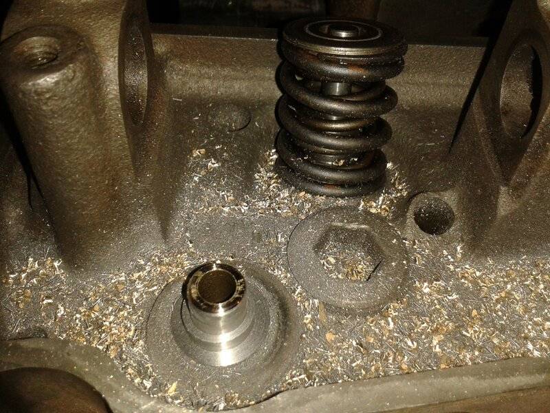

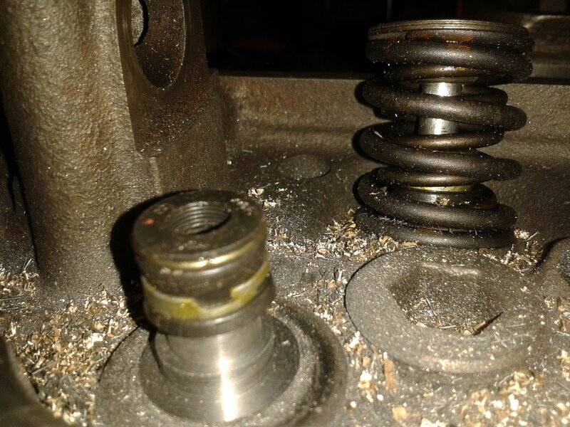

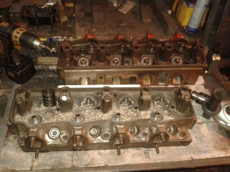

These are the Mods for the new Neilson .525 camshaft he got when he was last over, for dual spring Comps!
Poly seat mods for .525 cam.jpg Roosta Poly heads.jpg Poly valve seal mod.jpg

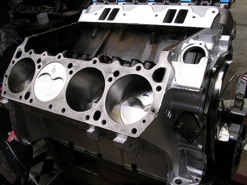

This was the 'other' engine we built when Rupert went 402ci poly!
542ci 440 engine, first one in the UK, back in the day lol.
If you look closely, you can see a row of bolts along the lower pan rail.
This was the first 'Program 4-bolt splayed maincap' ever done in the UK too...:fool:
